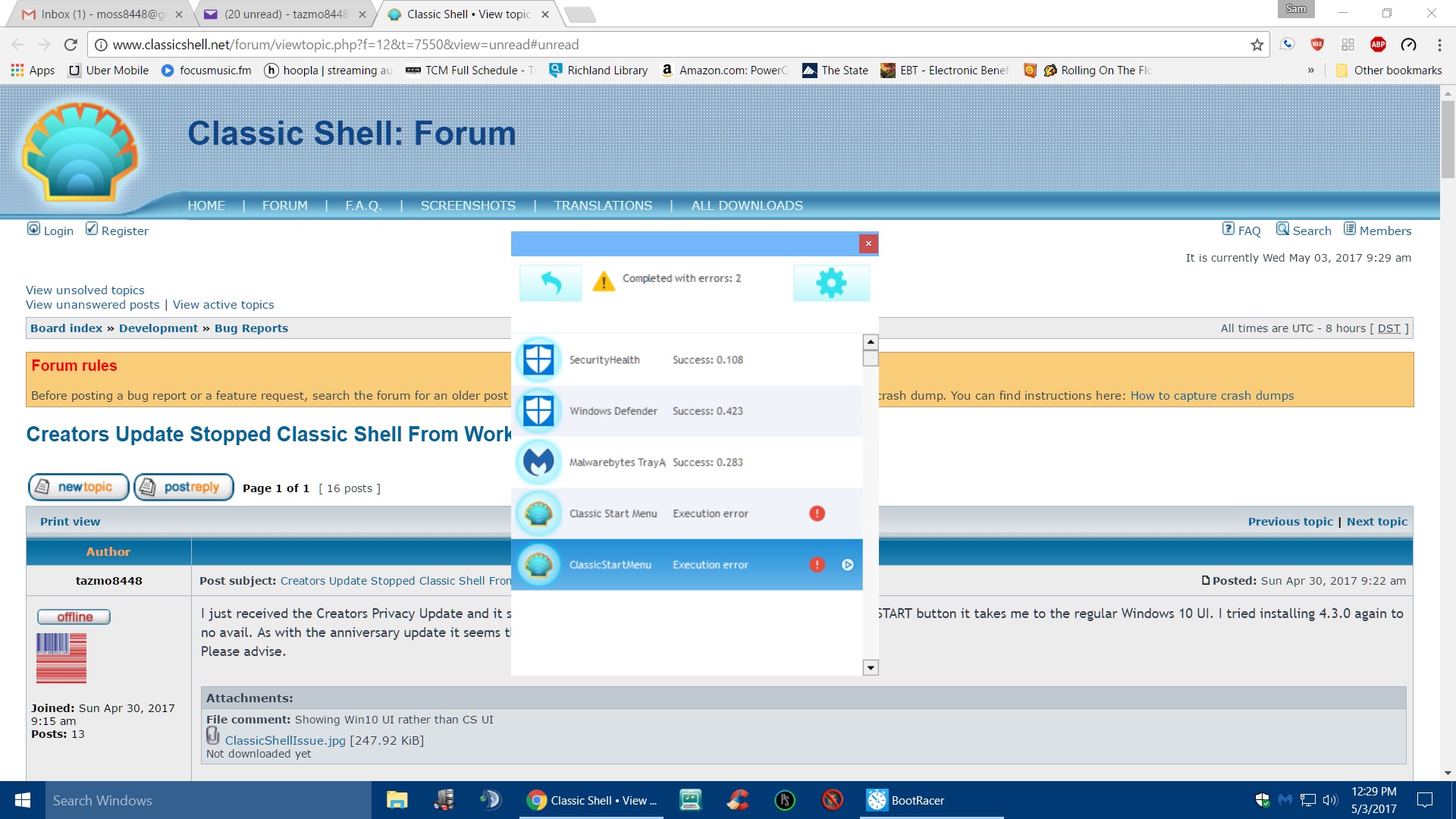

I am also attaching a screenshot using BooTracer that shows on startup two instances of CS not starting (error message)
File comment: BooTracer startup errors
BooTracer.jpg [340.18 KiB]

Okay I included the BooTracer Startup Log along with the CS_Log
File comment: CS_Log
CS_Log.txt [145.06 KiB]
Downloaded 2790 times
File comment: Showing Startup Programs
BooTracerStartup.jpg [499.44 KiB]

You have set ClassicStartMenu.exe to run as admin. It should not run as admin. Its main purpose is to hook into the Explorer process and should run with the same integrity level as Explorer.
Same for ClassicIE_64.exe
Also it appears you copied ClassicStartMenu.exe to the Startup folder instead of creating a shortcut there. The EXE can't run from that folder because it expects its other components to be in the same location.
