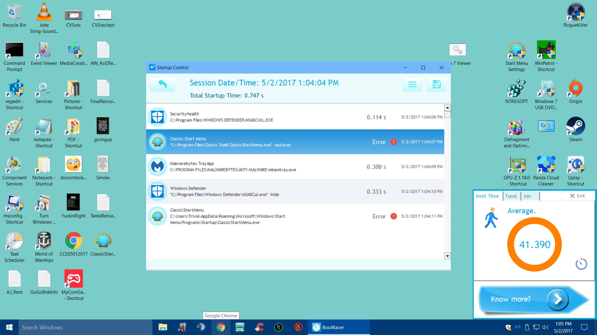

I am also attaching a screenshot using BooTracer that shows on startup two instances of CS not starting (error message)
File comment: BooTracer startup errors
BooTracer.jpg [340.18 KiB]

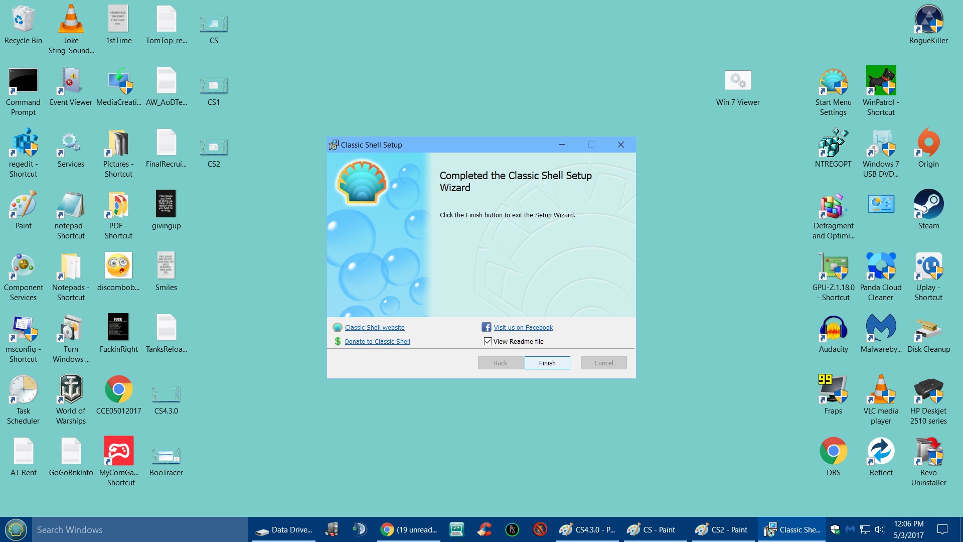

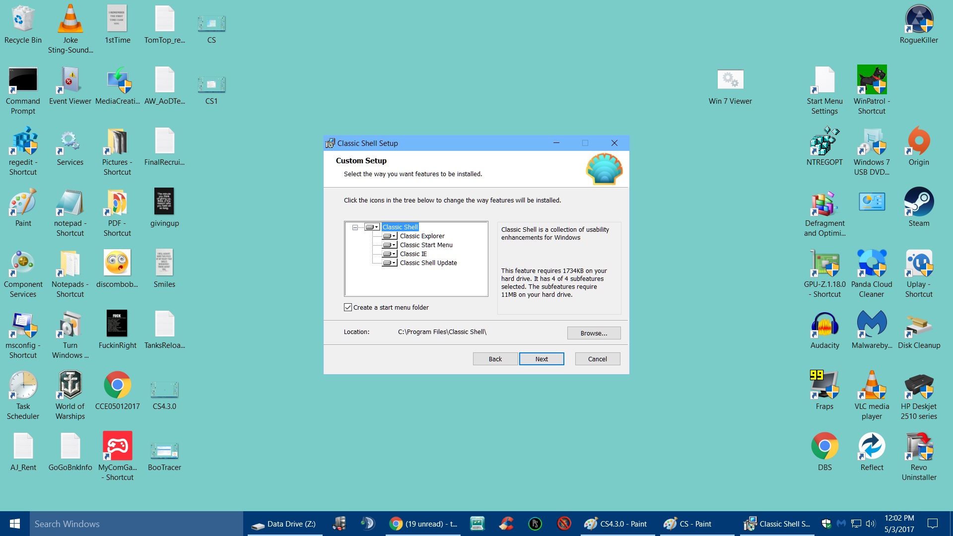

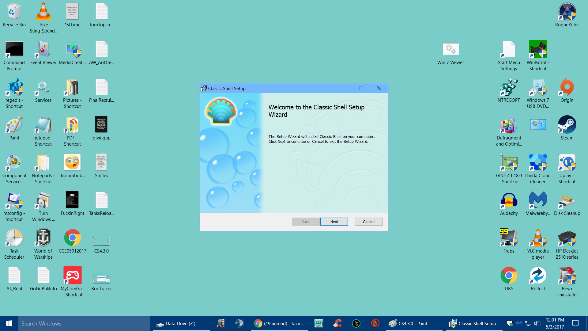

The one I have (and I will include screenshots) of the step by step that I see installing the utility. I uninstalled it an this is the sequence of re-installing.
Two more to follow.
Note:- I got the utility from the link you provided and it matched one I had gotten earlier. (4.3.0)
File comment: Run
CS1.jpg [317.81 KiB]
File comment: OPen
CS.jpg [286.53 KiB]
File comment: CS Program
CS4.3.0.jpg [235.08 KiB]

Here are the other two screens.
Note: Did not see anything that indicated log file.
The sequence is:
CS4.3.0
CS
CS1
CS2
CS3
File comment: Finish Screen
CS3.jpg [297.44 KiB]

PostPosted: Wed May 03, 2017 9:15 am
You are running the installer. You need to download the Classic Shell Utility - further down on the download page.

File comment: Showing Startup Programs
BooTracerStartup.jpg [499.44 KiB]

PostPosted: Sat May 06, 2017 7:43 pm
You have set ClassicStartMenu.exe to run as admin. It should not run as admin. Its main purpose is to hook into the Explorer process and should run with the same integrity level as Explorer.
Same for ClassicIE_64.exe
Also it appears you copied ClassicStartMenu.exe to the Startup folder instead of creating a shortcut there. The EXE can't run from that folder because it expects its other components to be in the same location.
