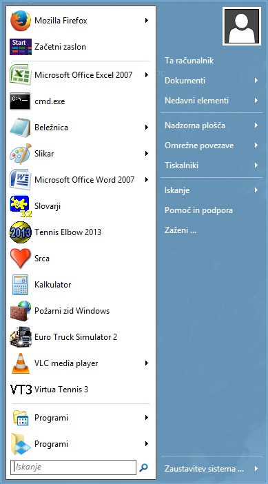

I wont start new topic.
I use menu with 2 columns and i set max recent programs to 30 or 20 but menu contains only 15 of them. Look at the picture.
I use version 4.1.0
Any suggestion?
 Post subject: Re: Menu Lines height
PostPosted: Thu Oct 22, 2015 2:22 am
The top two are pinned items. As you launch more programs using the Start Menu, the list will show 20 items.

I know about pinned recents. Sometimes i can see more recent programs but it seems classic shell doesn't have much memory because soon or later the oldest recent disappear.
PostPosted: Sat Oct 24, 2015 4:17 pm
Only the last 20 recent items are remembered.
PostPosted: Sat Oct 24, 2015 8:44 pm
If you change the large icon size from 32 to 24 on the "Menu Look" tab in Settings, you might be able to fit all 20 recent programs at your screen resolution. More than 20 is not possible.
