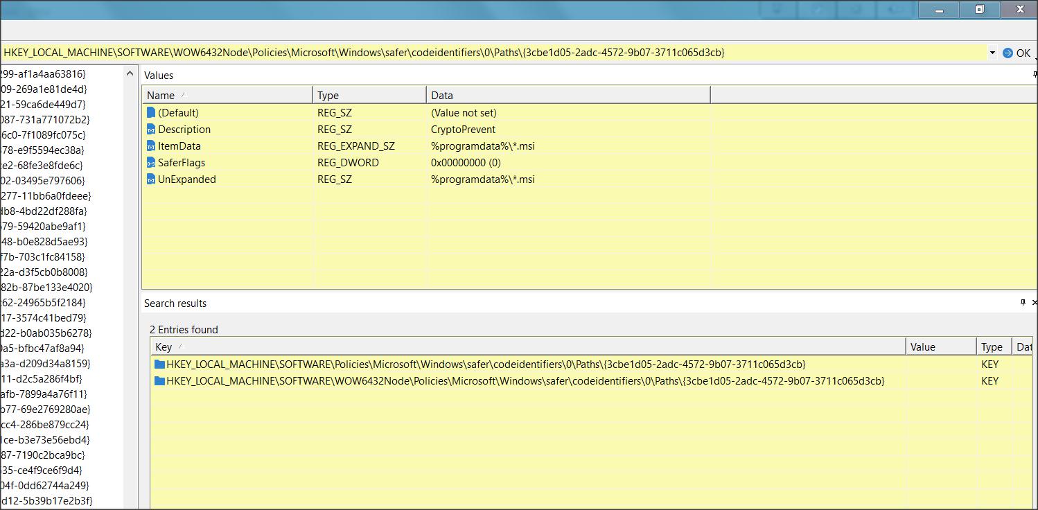

PostPosted: Mon Aug 14, 2017 6:05 am
Joined: Sun Apr 28, 2013 3:55 am
Posts: 15
I've found the restriction. It's set by an anti-ransomware program, Cyptoprevent.
Screenshot of registry keys attached.
I found that by searching the registry for 3CBE1D05-2ADC-4572-9B07-3711C065D3CB from the installer log.
But I can't see why v4.3.0 is unaffected.
1.jpg [136.4 KiB]
PostPosted: Mon Aug 14, 2017 7:58 am
Possibly this is some sort of reputation system, similar to smart screen or Norton AV. Once a file is installed by large number of people, it gains reputation that unblocks it.
PostPosted: Mon Aug 14, 2017 8:20 am
Posts: 15
Hi, not as far as I can see from its settings (see attached) - there's a specific rule which I would have thought would have applied not just to this version of CS, but to previous ones. Clearly something I don't understand or haven't yet come across.
I've tried adding an exclusion.
Anyway, if someone else has a similar problem, we know more! Thanks for your time, and a great program that puts MS to shame (did you know Win 10's start menu strips shortcuts out of start menu folders more than about 3 deep in a folder tree, and lists them alphabetically.. think
Help Help Help Help Help..... Readme Readme Readme... -each from a separate program).
