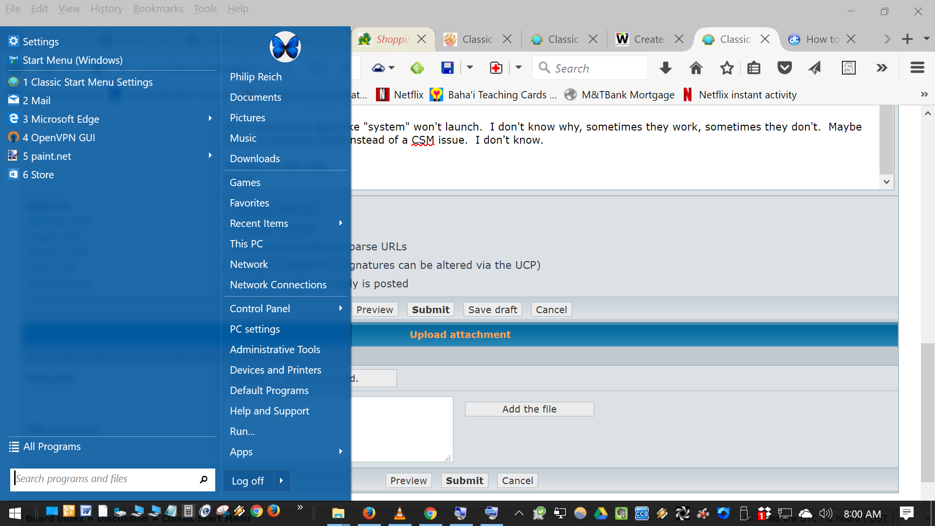

I was just upgraded to the windows creators update 1703. I was having problems with the start menu after it installed, and so I decided to download and install CSM because I was pretty fed up with the windows 10 start menu anyway.
However, after installation, the following occurred:
Instead of seeing a "stutdown" menu, what I see is a "logoff" menu.
I went into the CSM settings, and no matter what shutdown setting I tried to apply, this did not change.
Maybe a clue is that the option to "Show shutdown during remote session" has a lock on it, and says it is disabled due to group policies, but I haven't set any group policies. I am using windows 10 home edition, so I don't have the policy editor....
The settings I have set in the CSM shutdown settings selected are: Shutdown Dialog, and I have put the following commands in the "shutdown menu items" list: "switch_user,logoff,restart,sleep,hibernate,shutdown,lock". I also tried leaving the "shutdown menu items" list blank, which is supposed to default to all options, but that didn't work either.
I am able to use the win-x menu to shutdown the computer, and all the options show up there, but I would prefer to have this working in CSM.
Also, sometimes apps like "system" won't launch. I don't know why, sometimes they work, sometimes they don't. Maybe this is a windows issue instead of a CSM issue. I don't know.
I have attached a screenshot showing CSM, and also a system log produced by your CSM utility.

PostPosted: Mon Jul 17, 2017 8:13 am
It sounds like shutting down is disabled for your PC.
If you click on the Desktop, then press Alt+F4, do you see "shut down" in the list?
PostPosted: Mon Jul 17, 2017 8:43 am
Joined: Sun Jul 16, 2017 9:33 pm
No, shutdown is not disabled. When I press Alt+F4, it brings up the windows 10 shutdown options.

PostPosted: Wed Jul 19, 2017 10:02 pm
the REST_NOCLOSE policy is set to 48. That's un unusual value. It should be either 0 or 1.
It corresponds to this policy: "Administrative Templates\Start Menu and Taskbar\Remove and prevent access to the Shut Down, Restart, Sleep, and Hibernate commands"
See if you can disable it from gpedit.msc.
PostPosted: Wed Jul 19, 2017 10:55 pm
I found and installed gpedit.msc (I am running win 10 home edition), and updated the value to "disabled", rebooted the machine, and the behavior stayed the same. Is there a registry value I should be looking for?

PostPosted: Wed Jul 19, 2017 11:07 pm
Search the registry for a value named "NoClose" and delete it.
For me it is here: HKEY_CURRENT_USER\Software\Microsoft\Windows\CurrentVersion\Group Policy Objects\{212B0188-33B8-42FA-9A4F-C48AEA1F5EDF}User\Software\Microsoft\Windows\CurrentVersion\Policies\Explorer
I don't know if the location is the same for everybody
PostPosted: Wed Jul 19, 2017 11:09 pm
Actually, it is probably here: HKEY_CURRENT_USER\Software\Microsoft\Windows\CurrentVersion\Policies\Explorer
PostPosted: Thu Jul 20, 2017 4:20 am
I did a regedit, and searched for NoClose, and found something interesting -- there were 4 entries that were formatted like the first key you mentioned, but they contained the following REG_SZ type entry: "**del.NoClose", with a value of 0 (zero). It looks like something changed the names of these keys -- it wasn't me.
There were two places in the registry that were formatted like the second example you have, but the REG_SZ type entry was "NoClose", both had a value of 0 (zero).
I assume that the value of 0 (zero) is probably the default, which means the start button should be enabled -- correct?
I did not find one that had a value of 48. I don't think searching through the registry for "48" is going to find it -- there will be too many hits to ever find the right one.
Any further ideas?

PostPosted: Thu Jul 20, 2017 6:48 am
As far as I know the Home edition should not have any policies set. See if you can delete the two NoClose that you found. Maybe even having 0 there throws Windows off.
Other than that, no ideas.
