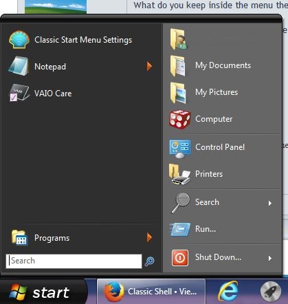

Here's a picture of my menu.

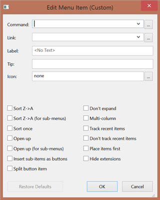

There is another way to increase the height of the menu. Add a custom item to the right column in between any two items where you want the menu to grow taller. Keep all its fields blank and set the icon to: none. This will add true empty space, the item you added won't even be selectable with the keyboard.

Hi. It did grow taller but I had to put a lot of them. I wish they still could add the option to make it taller like the Windows 7 Style. Better than nothing I guess. I'll have to tweak every skin. Thanks

The reason there is an option for Windows 7 is that the menu can switch between different modes - show pinned, all programs, search. You may want to have few pinned programs but want to see many results in search mode.
The Classic style doesn't do that, so the height is determined purely based on the contents. That's the "classic" way. No point of having large empty areas in the menu. If you really want large empty areas you can tweak the skin to insert more padding.
