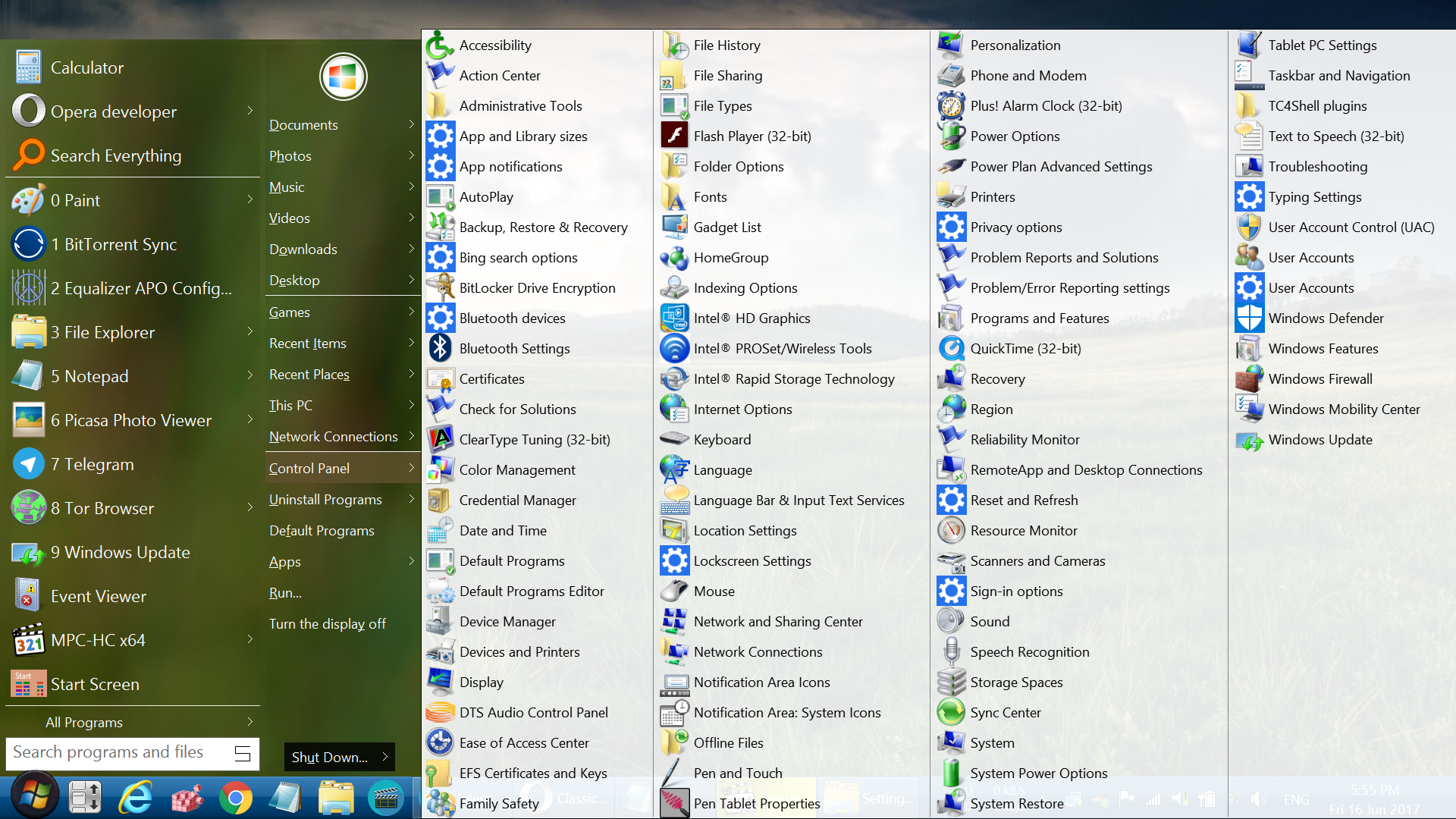

Here's a screenshot what I have accomplished till now:
PostPosted: Thu Jun 01, 2017 9:42 pm
Screenshot link is broken, or something.
No big shutdown ok :lol:
I'm trying your skin now.
The search box looks big already.
Unless you mean you want the white part with the S included on top.
If so, requires one or more Search_background, and Search_background_mask bitmaps, and a whole lot a text.
Patterns or emblems, it's up to you.
An emblem shows once. A pattern, once it runs out of image, it repeats itself again and again.
There are a number of ways to get the image to show through.
The actual image has like, say 150 alpha transparency in it, or the emblem1, or pattern1 mask could have 150/255 red.
The mask could have 150 alpha. It's all going to mix. Could even have original menu bitmap at 0 alpha, then the pattern mask, or image takes over. I have not tried all the ways.
Black is usually to block the image. Red relates to 1. green is 2. Blue is the pattern3/ emblem3
In the end it's the final alpha that Windows sees from CSM program that makes the blur.
It's funny. The alpha layer does not blur. I guess Windows adds another blur layer.
Take a look at blown up screenshot of Groove music player.
Windows added random dither noise to the alpha channel, for an artsy look.
You can see all the little pixels dots. Also see there is large blur radius behind.
I started to play with your skin. A user picture can not stretch.
I think on 7 style it has to use User_mask instead of a User_bitmap, to see desktop.
I put the User_mask bitmap at 128 alpha. It came out too milky.
Increased Main_bitmap=1 to 64 alpha. I'm running out of playtime. Will check back in a day, or two.

Yeah, You are right. All the alpha channels are blended together and resulting alpha is used. While what I want is that Background Image should be opaque And the white pattern behind the menu items should be of translucent and remaining spaces should have heavy blur. But, to do this, each individual image should have its own alpha and glass settings.
Later in the day, When i was continuing the work, I got an idea. Instead of classic shell (/Windows) make the desired blur, I added the blur to the image i was using as a pattern in photoshop. And made the white background behind menu items opaque and then adjusted the mask. It turns out to work and basic idea behind the skin is seem to nearly fulfilled.
But it has a major drawback, we can't use any image directly, instead we have to add blur before. But i think this can be solved if we can get another pattern for only the blur and adjust the mask settings.
But then another problem turns out, due to blending of two patterns, menu transitions become slow and starts lagging. (This might not be a problem and is happening on my laptop due to slow hardware, although I don't think laptop's hardware is that much slow, Try it on your PC).
And also, I am currently using pattern for imaging which is quite good but i think emblems can serve the purpose well for adjusting the alignments. But a problem is appearing there. When I edit the skin file to use emblems to mix two images or to use a mask (see in the skin file, It is at the top and commented out), and then saves everything and blah!! blah!! and then clicks the start button to open the start menu, explorer.exe (windows shell) stops responding and restarts. I don't know why it is happening. Also if i tried one image, everything is fine. Any Ideas??
So below is the revised skin file and menu settings and a screenshot. Although i have edited the skin thoroughly, it needs some more edits and a couple of new features which I will try to add tomorrow.
OK hope you try it.

PostPosted: Fri Jun 02, 2017 9:44 pm
Now skin looks like Crystal.
Looks good.
I think text is missing for List split selector.
Maybe you wanted it that way as it's hard to see the pin image.
You could borrow a bigger pin bitmap from another skin, along with its text.?
Yeah, something weird going on if emblem turned on. Maybe picture emblem is too big for middle position logic?
I would put everything on default 0 padding with Left Top position. See if that goes normal.
I read somewhere that's where it starts to draw it. From top left corner.
Sometimes these problems can take 15 minutes to fix, sometimes hours. I'll let you go for it.
If it works, great, if not, and since there is no texture on the 53 image, you could just reduce its size to a few pixels, and use as pattern for program to draw bigger.

Hello Juniper7, Below is the skin which is nearly complete.
Only three things are remaining:
1] Although I am testing the different options, I am not confident that there might not be any miss. So, can you please test some of the features especially Submenus and jumplist related as I don't use these features in daily life.
2] Any other recommendations
3] I have not adapted this skin for High DPI displays because I dont know how much Percentage is used. Can you do it for me. Or I have an Idea That I will borrow Percentages for other skin files, But don't know that it will work or not. Will It?
OK, When You said OK , I will make a new post for posting the skin.
Try it and tell me How it is?
SKIN AND MENU SETTINGS.zip [1.65 MiB]
Downloaded 6318 times

PostPosted: Wed Jun 07, 2017 7:25 pm
It takes a lot of work to put in so many options for a picture start menu. Less than a dozen have made one.
I like the asymmetrical circle user picture frame.
You've got to be the first person to put so many color pickers for options.
Spelling mistake in skin options Use white Seperators to Separators
Shutdown white arrow and white text not visible on white shutdown selector sometimes.
Might have to omit in that location (black always),
or show black only, if "Show Colored Background Pad" not picked?
I have to say, this happens only when your xml settings file is not loaded.
Beats me about using someone's picture. Could put a reference in your post, the link of where you downloaded it,
or thanking the artist by name?
I did not catch anything odd with jump list view.
Similar issue with the white arrows on white submenu, if xml not loaded. Maybe make a separate submenu white arrows option, or have show black ones, if submenu background color option not picked, or do nothing at all?
Any other recommendations? Aw, I miss Crystal mountain. It was pleasant to look at.
Probably picture too small, and would start to tile repeat on Hidpi.
High DPI. In most cases, it's not worth it, scaling up another batch of menu bitmaps.
The smaller the border, the less noticeable it becomes.

I can set it up so menu is at 150%/144dpi. What I'm saying is even though the arrows are made for 100%/96 dpi,
they still look acceptable (not tiny) at 144 dpi. I would not bother. Tell you what.
You can ask Gaurav what he thinks of your skin. I know he has a Hidpi monitor.

Here I made a screen shot of the last older skin at 144dpi.
Now you can decide whether to make arrows, user picture bigger?

You know I started to look at your latest skin. I saved all the skin resources to a folder.
Holy Batman. It mushroomed into a lot of bitmaps.
I tried your question 3 Card color preset to a color. I could not get it looking the right way.
Gave up on that.
Then decided to go back to the fishing boat in forest skin.
It's hard to figure out how transparency works with a pattern image. Talk about racking one's brains.
So complicated, I'm singing this, by the way. :lol:
I just want to put the basics in, no color picker stuff. Just to see if possible.
I'm not even making search, jump bitmaps. Only the main menu bitmaps, and pattern bitmaps.
So far I got working
Opaque inside/outside image
Opaque inside/outside image with light/dark borders
Transparent alpha same as above
Transparent Glass same as above
Opaque is still the best. Does not get washed out with a white window behind menu.
So going back to your question 2 with the new answer. By modifying main bitmap, can use opaque internal picture,
as well as an external opaque picture that will show with transparency alpha/glass on menu.
Will it slow down menu? Not on my computer.
The way I did it was depending if glass, or alpha option.
I made the main bitmap 1 alpha for glass, or 210 alpha for trans alpha. CSM opacity at default 50.
I had to set CSM override glass color to black, in order to get rid of metro glass color leakage.
The pattern mask has slit part mixed color 200 red (for pattern1 picture),
55 green (referenced to black so white menu lettering can be read.) How much it works, don't know. Maybe did nothing.
The part for light border is 190 red (for pattern1 picture), with 65 blue (pattern 3 referenced to a white pattern image)
Had to use a stronger pattern mask for dark border 127 red (for pattern1 picture),
and 127 blue (pattern 3 referenced to a black pattern image)
This old lean skin is in total shambles. I don't want to upload it, unless you want to copy parts over to your newer skin.
Here are a few pictures 75% resized, of what it looks like and the few options that make it work.
Bye for another day or two. :)

Hi meetHG and juniper7, lovely to see your skinning efforts. juniper7 is a skinning pro who has made some superb skins, some of them are better than even the skins shipping in Classic Shell.
Anyway, this is how your skin looks at high DPI. There are 2 screenshots. (Btw superb job with the way the custom image background is shown for the skin). :)
Let me know if you want a screenshot with some specific skin settings.
Some of the icons in the submenus and in search results touch each other, so you might want to increase their padding/spacing a little bit. Also if frames are enabled for submenus, they touch each other.
Also, the Shutdown button's arrow part could be bigger and have a separator from the left part (since it's a split button). In fact, the jumplist buttons could also be bigger and get a separator.

OK. I was waiting for your review. I will take a look and then inform you.
OK, Bye. Thanks
PostPosted: Fri Jun 16, 2017 5:58 am
Posts: 90
I take a look at the screenshot.
It was hard to view the image. Two times I tried to download but failed at 92%.
Then, simply viewed with the browser, still lower part don't show up.
No matter, Most of the menu showed up. I take a quick look.
It looks fine, although arrows seems to be little "little".
What do you think?
I noticed the submenus.
Yeah you are right. Icons seems to get into each other.
I will fix this one.
Same with search results will be done.
For shutdown and split selectors (jump buttons), do you want to increase the size of the second part where the arrows reside or the arrows itself.
Also, they do contain the separation but it is only 2 pixel wide so may be hard to see it.
No matter, I will fix this one also.
Thanks

I think, the area where the arrow is should be made much bigger and maybe a contrasting color for the separator. When touch features are enabled in the menu (Windows 8 and up), the Shutdown button can get much bigger if the skin specifies it.
For the skin I use on a daily basis, I have made its Shutdown button much bigger since I also have a touchscreen. It's a minor mod of the extremely awesome skin made by juniper7: (see the Shutdown button is almost as big as the jumplist buttons).

OK, I will do some modifications to Jump selectors and shutdown bitmap.
