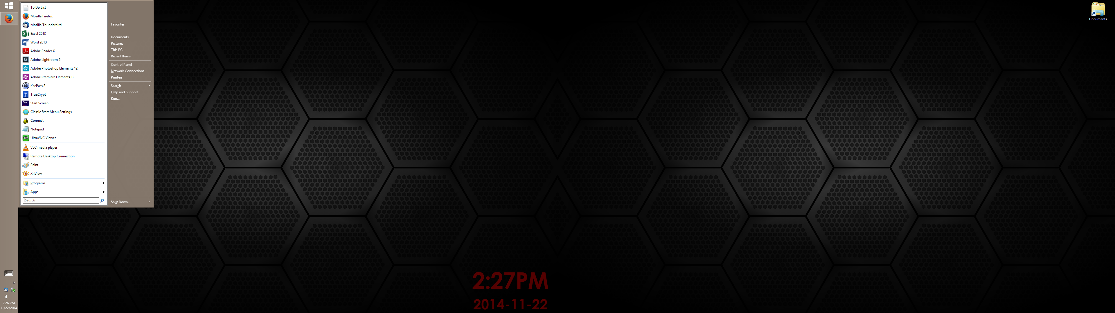

I was able to capture some screen shots, which I have attempted to attach. Perhaps this might help shed some light.
I didn't realize they would be attached for viewing in reverse order of their upload...
I encounter the missing Task Bar First, then I press the Start Button on the keyboard.
Don't know if that matters.
Thanks again for any insight.
File comment: This is what I see when I press the Windows button on my keyboard. The actual Start Menu looks and works as it should, it's the Task bar that is missing. Opening Classic Shell and going through the aforementioned procedure fixes the issue.

Author:  Ivo [ Sat Nov 22, 2014 12:33 pm ]
Post subject:  Re: Taskbar Becomes Transparent & Start Menu Disappears on S
It is not clear from the screenshot if the taskbar is transparent or simply black because the background image is also black there. Can you try with another background? Also try turning off the "taskbar transparency" setting. Also if you are using a non-default theme, disable that too.
