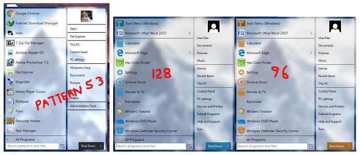

Few questions
1] Should i Use the pattern or emblem for the picture ? (that represented blue in color)
2] I have used pattern in the test skin above, but i have achieved the transparency, not blur. If you happen to see the skin file, tell if i have done anything wrong ?
Ok Thanks again

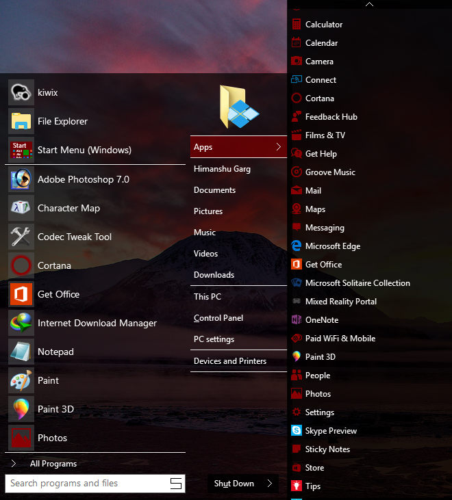

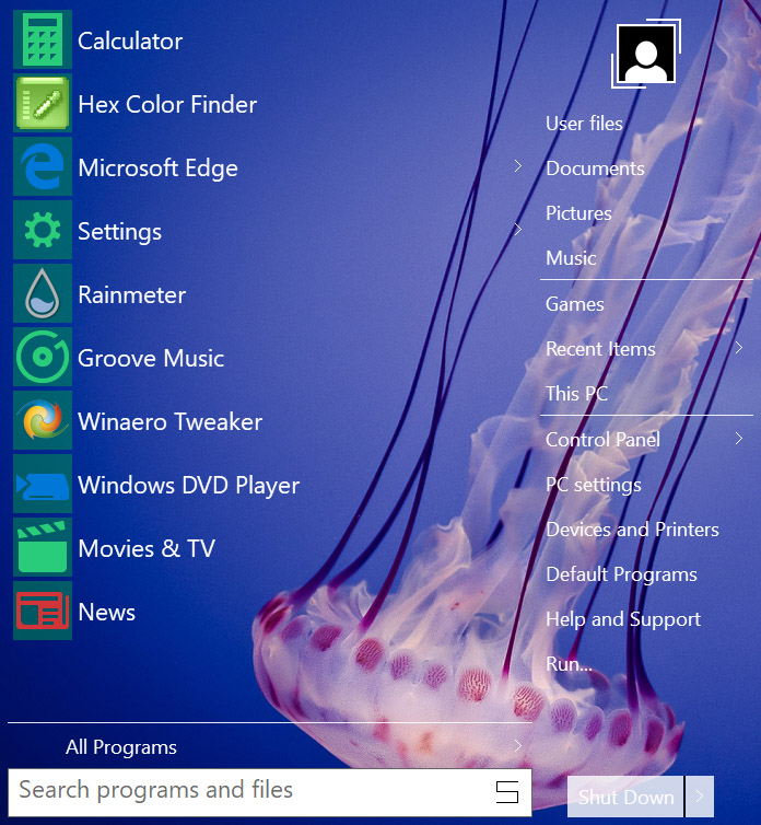

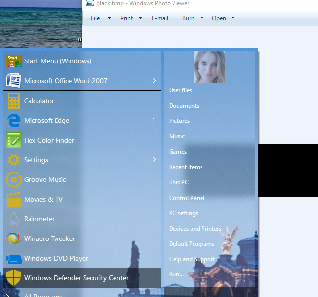

Here's a screenshot what I have accomplished till now:
PostPosted: Thu Jun 01, 2017 9:42 pm
Screenshot link is broken, or something.
No big shutdown ok :lol:
I'm trying your skin now.
The search box looks big already.
Unless you mean you want the white part with the S included on top.
If so, requires one or more Search_background, and Search_background_mask bitmaps, and a whole lot a text.
Patterns or emblems, it's up to you.
An emblem shows once. A pattern, once it runs out of image, it repeats itself again and again.
There are a number of ways to get the image to show through.
The actual image has like, say 150 alpha transparency in it, or the emblem1, or pattern1 mask could have 150/255 red.
The mask could have 150 alpha. It's all going to mix. Could even have original menu bitmap at 0 alpha, then the pattern mask, or image takes over. I have not tried all the ways.
Black is usually to block the image. Red relates to 1. green is 2. Blue is the pattern3/ emblem3
In the end it's the final alpha that Windows sees from CSM program that makes the blur.
It's funny. The alpha layer does not blur. I guess Windows adds another blur layer.
Take a look at blown up screenshot of Groove music player.
Windows added random dither noise to the alpha channel, for an artsy look.
You can see all the little pixels dots. Also see there is large blur radius behind.
I started to play with your skin. A user picture can not stretch.
I think on 7 style it has to use User_mask instead of a User_bitmap, to see desktop.
I put the User_mask bitmap at 128 alpha. It came out too milky.
Increased Main_bitmap=1 to 64 alpha. I'm running out of playtime. Will check back in a day, or two.

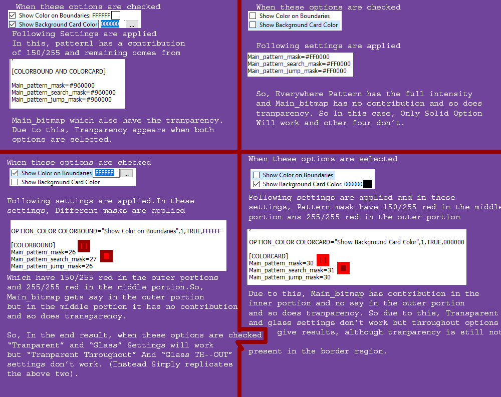

I got tired of changing pattern1 image . I put this text so I could do without openinclosing file:
OPTION_IMAGE CUSTOM_IMAGE=#7034,0
[CUSTOM_IMAGE]
Pattern1=@CUSTOM_IMAGE@

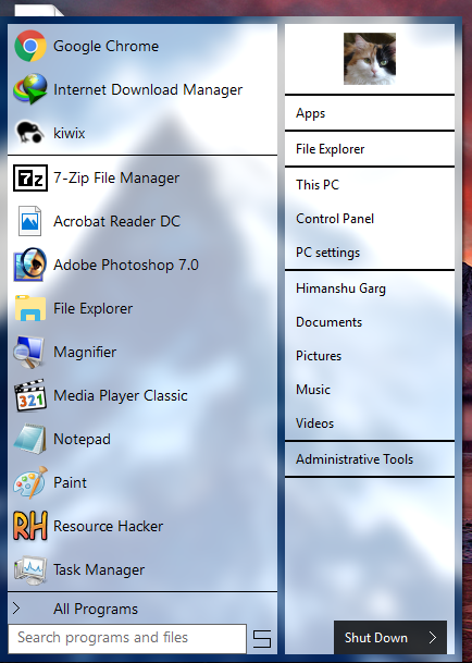

Yeah, You are right. All the alpha channels are blended together and resulting alpha is used. While what I want is that Background Image should be opaque And the white pattern behind the menu items should be of translucent and remaining spaces should have heavy blur. But, to do this, each individual image should have its own alpha and glass settings.
Later in the day, When i was continuing the work, I got an idea. Instead of classic shell (/Windows) make the desired blur, I added the blur to the image i was using as a pattern in photoshop. And made the white background behind menu items opaque and then adjusted the mask. It turns out to work and basic idea behind the skin is seem to nearly fulfilled.
But it has a major drawback, we can't use any image directly, instead we have to add blur before. But i think this can be solved if we can get another pattern for only the blur and adjust the mask settings.
But then another problem turns out, due to blending of two patterns, menu transitions become slow and starts lagging. (This might not be a problem and is happening on my laptop due to slow hardware, although I don't think laptop's hardware is that much slow, Try it on your PC).
And also, I am currently using pattern for imaging which is quite good but i think emblems can serve the purpose well for adjusting the alignments. But a problem is appearing there. When I edit the skin file to use emblems to mix two images or to use a mask (see in the skin file, It is at the top and commented out), and then saves everything and blah!! blah!! and then clicks the start button to open the start menu, explorer.exe (windows shell) stops responding and restarts. I don't know why it is happening. Also if i tried one image, everything is fine. Any Ideas??

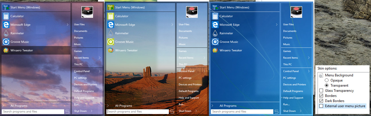

So below is the revised skin file and menu settings and a screenshot. Although i have edited the skin thoroughly, it needs some more edits and a couple of new features which I will try to add tomorrow.
OK hope you try it.

PostPosted: Fri Jun 02, 2017 11:01 am
Hi.
I don't know if there is any kind of image that can blur like a real piece of physical diffuse glass, just by putting behind.
It would have to scatter the light going through it in different directions. Need a program to do it.
Alpha blending slows down menu operation. There is a note in the skinning tutorial about it,
and ways to reduce it. If I understand it correctly, the actual picture should have the alpha transparency,
not the pattern mask. I have only noticed animation slowdown with 150% DPI setting in CSM.
Now we know why Ivo didn't have pattern feature for submenu. It puts too much stress on graphics processor.
I don't have time to look at your files. Whenever I get the menu crash and restart explorer,
it was my fault. :x
Turn on "Report skin errors "in CSM settings. Sometimes a window will pop up saying what the error is.
Most of the time is a mismatch of bitmaps used, a wrong dimension, or maybe trying to use a pattern mask,
when it should be an emblem mask? I'm amazed sometimes that even when I intentionally leave mismatches in,
the program can still work. Which reminds me, at some point, I have to fix a bitmap mismatch in the Bare Glass skin. Sometimes turning off all skin options can narrow down where the error occurs.
I don't remember if I mentioned this already about shutdown button, oh no, that was about the its color mask.
Um, if you want to make the shutdown button invisible, unless hovering, make the top 1/3 of shutdown bitmap
with 0 alpha.
Also, are you aware a 7 style main menu has 3 bitmaps?
main normal view, search view, and jump list view.
PostPosted: Fri Jun 02, 2017 7:44 pm

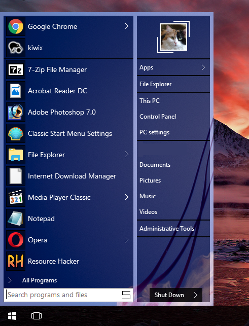

PostPosted: Fri Jun 02, 2017 9:44 pm
Now skin looks like Crystal.
Looks good.
I think text is missing for List split selector.
Maybe you wanted it that way as it's hard to see the pin image.
You could borrow a bigger pin bitmap from another skin, along with its text.?
Yeah, something weird going on if emblem turned on. Maybe picture emblem is too big for middle position logic?
I would put everything on default 0 padding with Left Top position. See if that goes normal.
I read somewhere that's where it starts to draw it. From top left corner.
Sometimes these problems can take 15 minutes to fix, sometimes hours. I'll let you go for it.
If it works, great, if not, and since there is no texture on the 53 image, you could just reduce its size to a few pixels, and use as pattern for program to draw bigger.
About search, and jumplist bitmaps pattern masks, emblem masks.
Wasn't sure you knew. If you do add a bitmap to extend the right side of search box,
more pattern/emblem masks might be required.
Have I been drinking too much ginger beer?
I see double images on above posts. I kept looking back and forth for differences.
Yes, the difference is uploaded picture, and linked picture?

Have pattern mask 255 red, with 96 red on the slits part. No green.
The light and dark parts of menu are not as dynamic looking as yours,
as when pattern 53 white image is used. Funny, I wonder why? It must clip/over expose in some way?
I better get back to my other work. Bye

In case you are interested in a wider search box with your "S" inclusive,
here you go. The zip has the matching bitmaps to install.
Goodnight :)
Search_padding=0,0,0,0
Search_frame=0
Search_background=32
Search_background_mask=33
Search_background_slices_X=0,1,1, 0,13,4, 1,1,0
Search_background_slices_Y=0,1,1, 1,2,1, 1,1,0
Search_background_padding=0,0,0,0
Search_background_search_padding=0,0,0,0
Search_background_jump_padding=0,0,0,0
;Search_hint_font="Segoe UI",italic,-9
;to block pattern image showing inside search box
Search_pattern_mask=34
Search_pattern_search_mask=34
Search_pattern_jump_mask=34

OK, One question. If it has worked in the above way, then this might means that we are stuck with the left/top alignment. If this is the case, then there is no reason to use the emblems as patterns do the same and I want emblems for the alignemnt purposes.
[It would take a while to find out exactly how combinations of patterns and emblems,
along with transparencies/not transparencies of image 53, go together.]
I think I know, The alpha transparencies of the Pattern1,2,3,4 and Main_bitmap mix together to create a new resultant alpha transparency layer and this layer get the blur or anything else. Alpha transparency of the Main_pattern_mask is not included as it is used for blending contribution of the fourth pattern or emblem. I don't know it for sure and can be wrong.
[EDIT: I was thinking after posting.
Maybe you don't even need image 53.
If all you are doing is adding a mix of non textured white using the green part of the regular
EDIT: Again last one, really. :)
Now you got my curiosity going. I had to see what happens.
I better get back to my other work. Bye]
Yeah, I figure it myself before reading your post and also had tried it and it worked.
For the first case about tint colors, it may had not work because I think mask is not active and is commented out. May be, I am not sure as I am through editing the skin and had left the above uploaded file far behind.
For the second case, I had done this and now I am using it. But I haven't noticed the difference in the look with and without Patterns 53 before but Now I do. I will try to figuring it out and try to devise some new way.
[In case you are interested in a wider search box with your "S" inclusive,
Goodnight................]

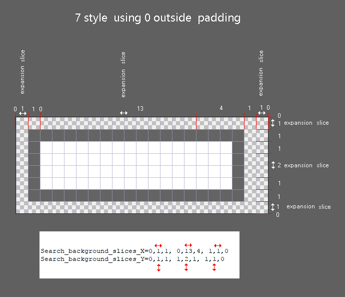

Here is another picture to help understand all the slices, in this case, for taller search box.
TALLER WIDER alternate search box
If you absolutely want a taller wider search box, it becomes more complicated.
You see, the vertical size of search box changes with the main font size, or dpi.
which you have at -11 already. I don't think it can get any taller.
Upping the search hint font will only cut off the bottom letters.
I don't think text "Search_text_padding=1,6,1,6" can even work in search box.
An extension part of search background would need to be added, that could trick it.
You see, in a normal Win7 menu, there is padded white space around the search box.
That is what those extra slices, that Ivo put in, are for.
Those extra slices are for the outside of the search box area, where you can increase the Search_padding.
In this case, putting the box line on the outer slice edge along with altered slices and padding text,
we trick it so the outside is part of the inside. :)
It needs a whole new set of matching bitmaps to use.

Tall and Wide search box.zip [1.05 KiB]
Downloaded 4999 times

Hello Juniper7, Below is the skin which is nearly complete.
Only three things are remaining:
1] Although I am testing the different options, I am not confident that there might not be any miss. So, can you please test some of the features especially Submenus and jumplist related as I don't use these features in daily life.
2] Any other recommendations
3] I have not adapted this skin for High DPI displays because I dont know how much Percentage is used. Can you do it for me. Or I have an Idea That I will borrow Percentages for other skin files, But don't know that it will work or not. Will It?
OK, When You said OK , I will make a new post for posting the skin.
Try it and tell me How it is?
SKIN AND MENU SETTINGS.zip [1.65 MiB]
Downloaded 5704 times

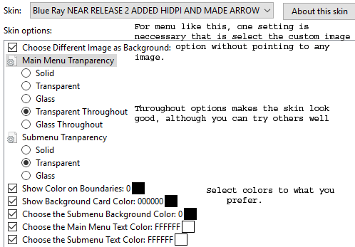

And, One thing. Above I mentioned the time lag in animations. I found the root cause of this today morning. It was due to setting "show frequent apps" in the classic shell menu settings.
If you replace that with"Show recent apps" or "No apps" , time lad considerably reduces.
And menu settings above still need to be updated for "show recent apps"
Hope you will try this when you are free.
OK, bye. Have a good day
PostPosted: Wed Jun 07, 2017 7:25 pm
It takes a lot of work to put in so many options for a picture start menu. Less than a dozen have made one.
I like the asymmetrical circle user picture frame.
You've got to be the first person to put so many color pickers for options.
Spelling mistake in skin options Use white Seperators to Separators
Shutdown white arrow and white text not visible on white shutdown selector sometimes.
Might have to omit in that location (black always),
or show black only, if "Show Colored Background Pad" not picked?
I have to say, this happens only when your xml settings file is not loaded.
Beats me about using someone's picture. Could put a reference in your post, the link of where you downloaded it,
or thanking the artist by name?
I did not catch anything odd with jump list view.
Similar issue with the white arrows on white submenu, if xml not loaded. Maybe make a separate submenu white arrows option, or have show black ones, if submenu background color option not picked, or do nothing at all?
Any other recommendations? Aw, I miss Crystal mountain. It was pleasant to look at.
Probably picture too small, and would start to tile repeat on Hidpi.
High DPI. In most cases, it's not worth it, scaling up another batch of menu bitmaps.
The smaller the border, the less noticeable it becomes.
PostPosted: Thu Jun 08, 2017 7:24 pm
Posts: 90
You like the asymmetrical circle. Thanks.
Seperators are now Separators. This was not new to me.
I had done this mistake many times even while creating the skin.
For Shutdown Text Color, I added A new Color Picker.
For Shutdown arrow, I separated it from Other white arrows option.
Same For Submenu arrows and separators.
Before adding that I tried many ways, But at some condition problem arises.
So, I simply done the above.
I don't know Who's the artist is. It was in the theme I downloaded from the themepack.me.
So , Will I just add this to the reference?
That Mountain Picture. It is at the end of reply.
Also I cropped the jelly fish picture in the revised skin file to get the more veiw of Jelly fish in the main menu.
I don't get it. Do you want me to make big arrows or small one? At normal DPI Or higher DPI?
Please explain.
User Picture and adjustments are still needs to be changed.
I don't get What I have to do. Do I have make New Frames With 1.5 times 64 (=96) pixel size.
Or Something else.
And adjusting padding will be difficult one as I can not see what I have done.
I tried to manually override dpi (at 144) in the Classic shell settings, but in vain. Menu Turns out to be Godzilla.
Yeah, You are right. Transparent and glass shows transparency on the boundaries.
These are like alpha and glass.
And Throughout options are like fullalpha and fullglass.
Yeap, They work even with external picture.

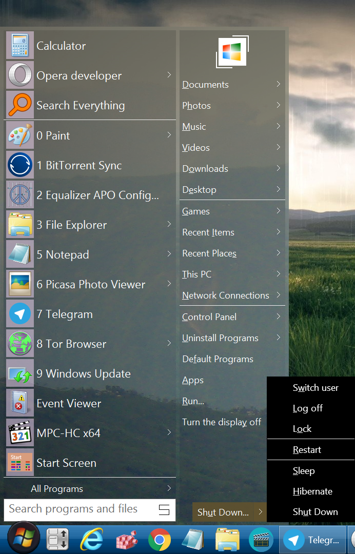

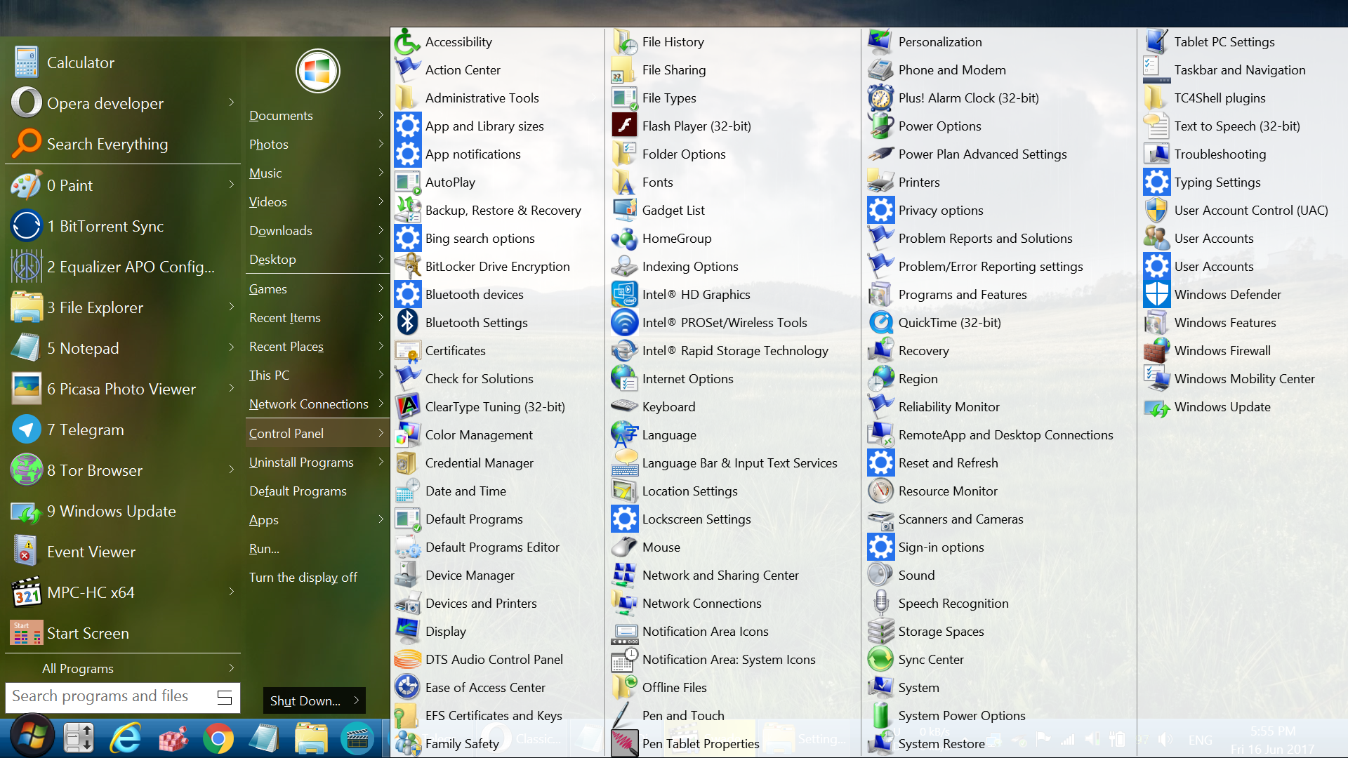

Here I made a screen shot of the last older skin at 144dpi.
Now you can decide whether to make arrows, user picture bigger?

PostPosted: Sat Jun 10, 2017 12:43 pm
Hello
All I did was add the arrows, and user picture parts as png images(to save some file size),
and add the HiDPI text at bottom of script.
At 144 DPI, the arrows are larger, but they look thin next to thicker text.
You might want to thicken up HI-DPI arrows? I think it's due to the busy jellyfish image.
Also on 144DPI. When you moved the jellyfish image to left in new version,
jump list view now shows end of picture, then repeats. It looked fine (no tile repeat), on last version.
Maybe put both images in skin file(file getting bigger). Then 100% reg size assigned to use latest modded image, and assigned under HiDPI to use the older image?
I never noticed before, but the glass and transparent throughout option,
only works if "Show background card color" is checked? Something odd with text logic, or you wanted that way?
About user picture. I notice on reg size, that the square black frame has transparency.
all the rest of bitmaps have opaque frames? Which looks better? I don't know.
If a user picture is black, you will see a brighter top/left pixel line. Barely noticeable with detailed picture.
If you don't want line to show, one way is to hide edge of picture behind an opaque frame.

Something is weird with the Under Construction Blue Ray zip.
People have gone nuts and downloaded it 22 times. :lol:
That's nice, but all the bugs have not been removed.
And it would have to be where I used huge show and tell png pictures. Sorry.
Should I delete the zip to stop people from downloading?

PostPosted: Sun Jun 11, 2017 10:01 am
Posts: 90
Yeah, you are right. People actually have gone nuts.
Neither my previous crystal skin nor any of the skins i posted above are downloaded this much.
And Most funniest thing is I have not downloaded the zip till the writing of this reply.
Actually, I am kind a stuck with downloading.
My Internet modem can provide download speeds of about 300 Kbyte to 1 Mbyte.
But whenever I try to download the skin file download speed is throttled to about 5Kbyte.
I had tried about 6 times with same end result.
"Download Failed".
Looks like I have to try another way out.
So, don't delete the zip.
I will tell you when to delete the zip as soon as I downloaded it!
And For the transparency of Jellyfish, I searched on wikipedia.
They said that most of jellyfish is made up of water so it is transparent.
Might the skin needs water!!
Jokes apart
Later in the day, I try to figure out the reason in my version of skin and SUCCESS.
So, Reason is:
Whole transparency (or alpha channel) comes from Main_bitmap.
Jellyfish Image Is completely Opaque.
So, when we have checked the "Choose Card Color" Option,
Pattern Mask is set to work and it reduces the contribution of image to 96/255 in the middle area where color actually shows up.
So, alpha transparency (or main bitmap) have a good say in the final result.
But, when it is checked off, Pattern_mask is #FF0000 which eliminates the contribution of Main_bitmap.
Due to this no transparency.
So, tell me What should I do. I see three choices:
1] Leave things as they are.
2] Add Another Similar Jellyfish Image Resource with transparency added. This makes things somewhat comlicated.
3] Change the Pattern_mask when option is unselected (from #FF0000 to some other). This option provides transparency of main_bitmap to the final result (as required)
but also provides some of it's RGB color (which I think is white) (which is not required). So, this means unselecting the Option don't turn off the colors but instead set it to default. (White).
4] Later in the Late day(!), I found one more option: Disable the Glass And tranparent throughout options if "Show color card" Option is not checked and Disable Glass And Transparent Options If "Show Coloured Boundaries" Options Unchecked And Disable the preceding four If both options are unchecked. But, I know how to disable OPTIONS, Can RADIO_GROUP Options can also be turned off in this way.
OK, bye.
Have A good day.

PostPosted: Mon Jun 12, 2017 7:28 pm
You know I started to look at your latest skin. I saved all the skin resources to a folder.
Holy Batman. It mushroomed into a lot of bitmaps.
I tried your question 3 Card color preset to a color. I could not get it looking the right way.
Gave up on that.
Then decided to go back to the fishing boat in forest skin.
It's hard to figure out how transparency works with a pattern image. Talk about racking one's brains.
So complicated, I'm singing this, by the way. :lol:
I just want to put the basics in, no color picker stuff. Just to see if possible.
I'm not even making search, jump bitmaps. Only the main menu bitmaps, and pattern bitmaps.
So far I got working
Opaque inside/outside image
Opaque inside/outside image with light/dark borders
Transparent alpha same as above
Transparent Glass same as above
Opaque is still the best. Does not get washed out with a white window behind menu.
So going back to your question 2 with the new answer. By modifying main bitmap, can use opaque internal picture,
as well as an external opaque picture that will show with transparency alpha/glass on menu.
Will it slow down menu? Not on my computer.
The way I did it was depending if glass, or alpha option.
I made the main bitmap 1 alpha for glass, or 210 alpha for trans alpha. CSM opacity at default 50.
I had to set CSM override glass color to black, in order to get rid of metro glass color leakage.
The pattern mask has slit part mixed color 200 red (for pattern1 picture),
55 green (referenced to black so white menu lettering can be read.) How much it works, don't know. Maybe did nothing.
The part for light border is 190 red (for pattern1 picture), with 65 blue (pattern 3 referenced to a white pattern image)
Had to use a stronger pattern mask for dark border 127 red (for pattern1 picture),
and 127 blue (pattern 3 referenced to a black pattern image)
This old lean skin is in total shambles. I don't want to upload it, unless you want to copy parts over to your newer skin.
Here are a few pictures 75% resized, of what it looks like and the few options that make it work.
Bye for another day or two. :)

Hi Juniper7
1] First of all sorry, I have done a mistake in understanding the Problem of transparency.
And that mistake also reproduces in my last reply.
Look at the picture below to understand why transparency and blur not works.
2] It took a good amount of time to understand your reply. Pardon My English understanding capacity.
And, I am not sure that I had understand it correctly.
So, according to my understanding, you gone to an old skin.
And then made some changes to the Main_bitmap_mask And Pattern_mask
to solve the problem: Transparency and Glass don't work if "Show Background Card color" option is not checked.
And you solve it by making alpha=1/255 in the Main_bitmap for glass
and alpha=210/255 in Main_bitmap for transparency.
You also added some other pattern to make the text reading easier.
So, tell me If I understand you correctly?
3] If yes, then here's my view:
Actually, transparency is present already in the Main_bitmap.
But due to Pattern_mask=#FF0000, Pattern1 takes all the contribution
and Main_bitmap has no say in the Final Result and so does transparency. (As you Can See in the picture above.)
So, What now? I hope leaving things as they are might be the best option.
4] Below is the Updated skin file For HIDPI. I Have Made arrows thicker so you can check if they looks OK or not. I also Changed the default jellyfish picture (Kind bored with it). New Picture with Blur looks great, What do you think?
If you find any problems, tell me.
5] I have finally downloaded your ZIP, so you can remove it if you want.
OK, Bye.

PostPosted: Thu Jun 15, 2017 9:40 am
Posts: 90
Hi, I take a look at your skin.
Yeah, you had make transparent menu by using Main_bitmap, patterns and masks.
But, My skin can do that too.
The problem arises only when "Show background color" is not checked.
As your skin haven't that option, the color in the Main_bitmap or in the pattern is used all the time. (which is black).
Look below at the picture.
In the left, it's your skin having black tint in the middle portion
To the right is mine one, having no tint, it is original jellyfish image color. (When "Show Background Color" is unchecked)
These tint colors can be confusing. I got myself confused many times when writing options in the skin file.
Here's a little equation which helped me:
Showing original pattern(Image) color = Not showing any color ≠ Showing Black Color
Might this help you.
I am waiting when you become free of your daily job.
Difference in the central area (Left is yours and Right is mine).png [ 869.38 KiB | Viewed 359492 times ]
PostPosted: Thu Jun 15, 2017 12:05 pm

Hi meetHG and juniper7, lovely to see your skinning efforts. juniper7 is a skinning pro who has made some superb skins, some of them are better than even the skins shipping in Classic Shell.
Anyway, this is how your skin looks at high DPI. There are 2 screenshots. (Btw superb job with the way the custom image background is shown for the skin). :)
Let me know if you want a screenshot with some specific skin settings.
Some of the icons in the submenus and in search results touch each other, so you might want to increase their padding/spacing a little bit. Also if frames are enabled for submenus, they touch each other.
Also, the Shutdown button's arrow part could be bigger and have a separator from the left part (since it's a split button). In fact, the jumplist buttons could also be bigger and get a separator.
Hi DPI.png [1.86 MiB]
PostPosted: Fri Jun 16, 2017 5:40 am
Posts: 90
OK. I was waiting for your review. I will take a look and then inform you.
OK, Bye. Thanks
PostPosted: Fri Jun 16, 2017 5:58 am
Posts: 90
I take a look at the screenshot.
It was hard to view the image. Two times I tried to download but failed at 92%.
Then, simply viewed with the browser, still lower part don't show up.
No matter, Most of the menu showed up. I take a quick look.
It looks fine, although arrows seems to be little "little".
What do you think?
I noticed the submenus.
Yeah you are right. Icons seems to get into each other.
I will fix this one.
Same with search results will be done.
For shutdown and split selectors (jump buttons), do you want to increase the size of the second part where the arrows reside or the arrows itself.
Also, they do contain the separation but it is only 2 pixel wide so may be hard to see it.
No matter, I will fix this one also.
Thanks

Do you know that Blue ray skin can mimic a various other types of skin.
Below is the screenshot in which it looks like Metro (although some icons may be different like that of All Programs)
For this you have to set some settings as shown in the side picture.

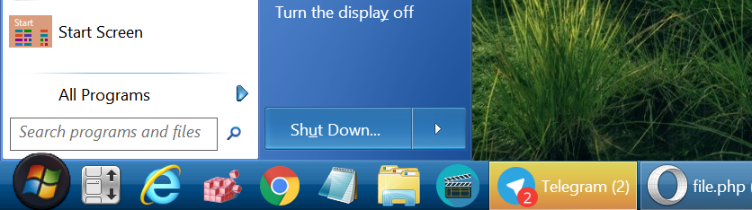

I think, the area where the arrow is should be made much bigger and maybe a contrasting color for the separator. When touch features are enabled in the menu (Windows 8 and up), the Shutdown button can get much bigger if the skin specifies it.
For the skin I use on a daily basis, I have made its Shutdown button much bigger since I also have a touchscreen. It's a minor mod of the extremely awesome skin made by juniper7: (see the Shutdown button is almost as big as the jumplist buttons).
PostPosted: Fri Jun 16, 2017 6:18 am
Posts: 90
OK, I will do some modifications to Jump selectors and shutdown bitmap.
