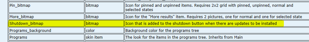

I was trying to get my Windows 10 computer to look as much like Windows 7. I noticed one thing I couldn't change that kinda disappointed me which was the shutdown button had an icon next to it if it had an update. I wanted to find a way to change it but I couldn't find one. If you can please add this in then thanks.

PostPosted: Fri Oct 28, 2016 12:40 am
http://classicshell.net/tutorials/skintutorial.html

Thanks but I kinda don't know how to change that. I was looking through all the skins in bitmap and couldn't find anything. I might have to add my own?
PostPosted: Fri Oct 28, 2016 11:32 am
Yes if it's not in the skin but it's there in the skin reference, you must add it. First add the bitmap or PNG resource using Resource Hacker and then define it in the skin.
