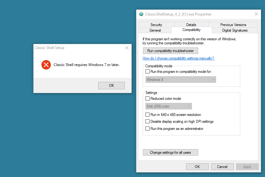

Hi, thanks for your replies.
I've tried downloading the installer again and it is still the same error.
I have W10 Home.
Am I the only one having this issue?
PostPosted: Wed Sep 14, 2016 7:19 am
Run it, save a log file, and send it to me.

Everything checks out. I don't know why the installer would think you are running on older version than Windows 7.
Use the compatibility tab to tell it you are on Windows 8 or something.
