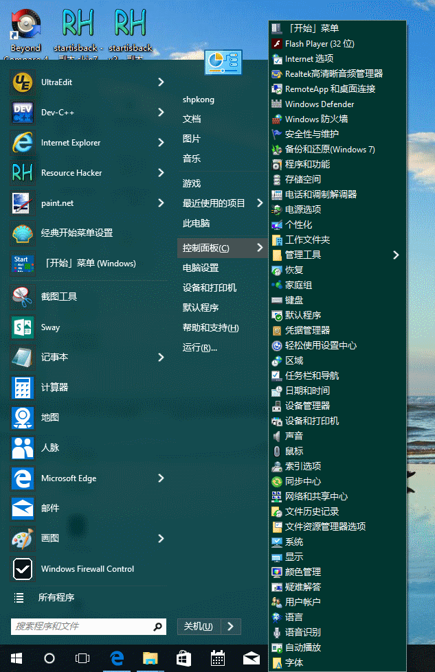

I am trying to make this skin like startisback's plain10 style (which is my favorite style) .
But I failed to add fullgrass effect to submenus as it is to the main menu.:roll:
May I ask how to add transparency to sub menus in classic shell?
In the .skin7 file, I have already removed all my false attempt to make the submenu transparency.
test.skin7 [185.56 KiB]
Downloaded 4450 times
PostPosted: Fri Aug 05, 2016 8:22 am
You need "Submenu_opacity=fullglass".
Take a look at the SmokedGlass skin for one example

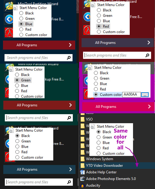

Just woke up early to a cold sweat.
Well ok, really, woke up to racoons foraging for food outside.
Nice idea putting the custom color picker for menu.
Could not go back to sleep, cause now something was bugging me.
Usually there are always windows updates that show up as new installed programs.
Never noticed anything wrong on your skin.
I just now downloaded a program to check what a new installed program looks like,
when submenu is transparent.
Oh no! See picture. New programs selector is only 24 bit, should be 32 bit for transparent.
Will have to add extra text to script, for it to look normal again. Ok back to sleep.
[TRANS_SUB AND NOT OPAQUE]
Submenu_bitmap_mask=28
Submenu_bitmap_slices_X=2,2,2
Submenu_bitmap_slices_Y=2,2,2
Submenu_selection=#555555
Submenu_selection_tint1=#555555
Submenu_selection_mask=28
Submenu_selection_slices_X=2,2,2
Submenu_selection_slices_Y=2,2,2
Submenu_split_selection=#555555
Submenu_split_selection_tint1=#555555
Submenu_split_selection_mask=29
Submenu_split_selection_slices_X=2,2,2,2,2,2
Submenu_split_selection_slices_Y=2,2,2
Submenu_new_selection_mask=33
Submenu_new_selection_slices_X=2,2,2
Submenu_new_selection_slices_Y=2,2,2
;Submenu_new_selection=#1a1a1a
;Submenu_new_selection_tint1=#165f81
;Submenu_new_selection_mask=#7F0000

PostPosted: Sun Aug 07, 2016 10:10 pm
Aye aye aye.
You posted a new version already.
I was making this picture of the new programs looks for you.
You are too fast. :)
Inner new programs changes color, main menu new changes color, just the submenu new keeps the same one color.
Just have to add the text for those different colors in those other color options.
Well now you have probably done all that in your new released skin.
I go back to troubleshooting why my $25 50 year old Harman Kardon A500 tube amp smoked and died on me. :cry:
This is going to be very expensive to fix. :|

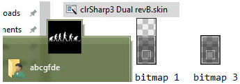

PostPosted: Fri Aug 12, 2016 9:02 pm
More on the user picture 1/2 out on Classic skins.
Here is another link from a persons skin that is simple to understand.
viewtopic.php?f=17&t=5785
On this one, the glass blur works,
because it is square user picture frame, without the almost transparent pixels that make the artifacts.
Even shadow works well.
Take a look at clrSharp3 Dual revB.skin from the Zip.
To show picture half out. He made invisible part at top of main bitmap. See bitmap 1
When no user picture is turned on, a smaller bitmap 3 (without transparent top) is used.
The vertical slices and padding are different for each bitmap.
no picture
Main_bitmap_slices_Y=23,9,9
Main_padding=12,26,6,12
Main2_padding=3,26,6,12
with user picture
There has to be more pixel height and padding to make up for the invisible part of bitmap.
Main_bitmap_slices_Y=48,9,9
Main_padding=12,51,6,12
Main2_padding=3,52,6,12

PostPosted: Fri Aug 12, 2016 9:24 pm
Joined: Thu Aug 04, 2016 7:04 am
Posts: 30
I see.
Maybe it is because do not know very well about the alpha channels.(why you call it alpha?:) )
I use PS to open the bitmap 1 in John's skin, may I ask whether is black related to full trans(not able to see).
Sorry for my English.
PostPosted: Fri Aug 12, 2016 10:04 pm
I'm not sure why it is called Alpha. You could look on a search engine site.
Alpha is one of the channels that a 32 bit bitmap can have.
red 8 green 8 blue 8 (alpha transparency) 8 = 32
Just like red can be almost black 1/255 with a little red, or very red with max 255/255
So can the transparency channel from totally invisible 0 to totally not invisible 255/255
Not all bitmaps are 32 bit. Some are only 24 bit, with just the red,green, blue, no alpha.
Not all image programs can import/export 32 bit bitmaps.
I think your one does.
It could show up as black or white, or checkered.
Usually there is an option in program to change what the transparency channel looks like.
There must be an eyedropper or some tool that gives alpha value. Go into help file if can't find it.
PostPosted: Tue Aug 16, 2016 12:43 pm
Getting back to you shpkong, about user picture 1/2 out on Classic style 1,2.
Did a test with standard Metro skin.
Nope, didn't work the way I thought it would.
I thought maybe an emblem could be a separate alpha window.
Same results as regular user bitmap (picture frame).
Whenever there is a light background desktop,
the outer pixels pick up the glass color, probably blur as well. (Jaggies)
Is not that noticeable with a dark background. See picture.
I set it back to user bitmap afterwards.
It works ok in opaque mode, just there won't be any menu shadow.
You could change the opacity text to fullalpha for the extra bitmaps that are used for fullglass,
but bitmaps might be too transparent.
I never tried the way Ivo said.
To have picture frame embedded into the main bitmap. Even if it did work better, might be hard to keep user picture centered,
as the stretching slices would have to be on the left or right of picture.
Edit: Tried it same.
Extra note.
If the "Glass opacity" (in CSM settings), is set to 0,
the glass color artifacts around the top half of user picture frame disappear.
There is just a little bit of the blurred pixels on the right side. Oh wait, maybe that is part of the shadow.
Works on HDPI too.
Shpkong. You could transfer all your personalized text from the other one, into this test skin?
Metro TEST Picture Out .skin [202.5 KiB]
Downloaded 4083 times
PostPosted: Fri Aug 19, 2016 5:32 am
Are you still working on your skin, shpkong?
I transferred some of your text into the test skin,
along with linking to Dave Stewart's icons, glass opacity at 0.
Only uploading picture, not skin.
Just to see what it looks like, if you continue. :)
PostPosted: Fri Aug 19, 2016 8:10 am
Posts: 30
Hi, juniper7. I am here.
Quite busy these days and did not have time to look into your skin.
It seems that you have already made the user image 1/2 out perfectly.:)
I'll look into your test skin tomorrow and find out what I can learn from it.
Please feel free to post the skin here and sign your name.
This skin is not made by me. I only make a few changes to the original metro skin. :)
PostPosted: Fri Aug 19, 2016 12:12 pm
We all use Ivo's skins as the base. Then we just add/subtract from it.
I wouldn't know how to make one from nothing.
Kind of busy this weekend.
I'll just upload it half and half done.
Will let you personalize it to your taste.
I find if menu opacity is at 0, and menu color on black, with white page as background,
kind of hard to see grey selector. It blends in with menu.
I now set to menu opacity to 15.
Also found if one wants menu blacker, use your custom menu color option, set to 000000
I switched the default FFFFFF to 000000.
Have a good weekend. :)
Metro half-halfTEST glassPicture Out .skin [208 KiB]
Downloaded 4369 times
