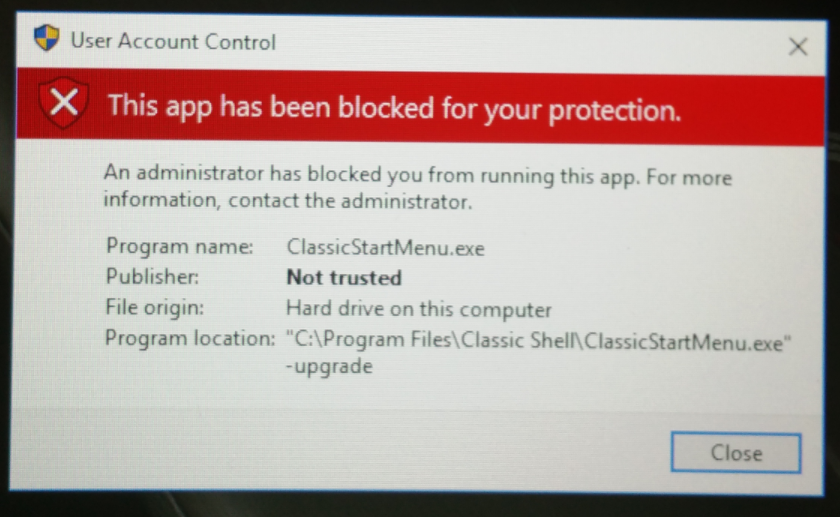

Windows 10 is blocking Classic Shell from working properly.
It gives me this message and I'm a Administrator and have no option to correct it.
John
PostPosted: Wed Jul 20, 2016 4:44 pm
Uninstall Classic Shell, then install the latest stable version 4.2.5c. If you use a pre-release insider version of Windows 10, then use the beta version 4.2.7.

PostPosted: Wed Aug 03, 2016 1:46 pm
Looks like a compatibility setting was added to ClassicStartMenu.exe to run as admin. This should not be done. The start menu is intended to run as a regular user, just like Explorer.exe.
Also, Windows does not allow startup programs that require admin.
PostPosted: Wed Aug 03, 2016 3:13 pm
Joined: Tue Aug 02, 2016 7:52 am
That was it !!! Turns out another in our volunteer group tried to make a version before 5.2c work by adding that setting. Removing it now allows the app to run as expected ! GREAT HELP, and I SINCERELY thank you profusely "!!
