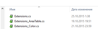

Can't get icons size adjust working for Explorer Details / table view, even i set up all to 24 size, still icons showing small - 16*16
Is there a way how to fix this ?
On W7, icons were view good (you can see icons even with svn icon added to them, but in w10 i almost can't see icon :)

The setting is for the buttons in the toolbar, not the files in Explorer.

Is there way to change icon size for files ?

You can increase your system DPI. Type: dpi into the Classic Shell Menu search, open DPIScaling.exe. Click "Set a custom scaling level" and set it above 100%. On Windows 10, you can also change it from the Settings app. Then log out and log in again. Your Explorer Details/Table view items should be larger.

it's not same, as it will increase size of text, which i do not want to change, only icons size

Then there is no other way. The File (right side) pane of Explorer uses an undocumented control so third parties can't predictably modify its behavior.
