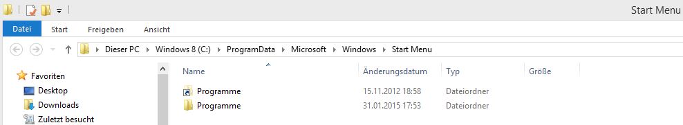

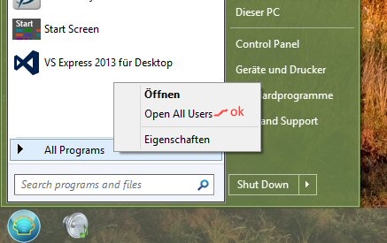

Yes, the call from 'All Programs' works correctly. (see pic 1, pic 2)

Why do you have two "Programme" items in your start menu folder? I suspect there is some mixup with your start menu folders.

Menu 'All Programs' -> 'All Users' no problem
