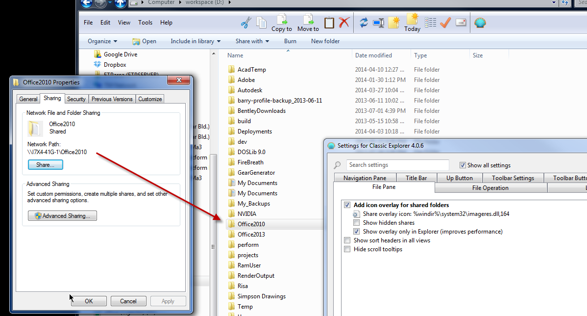

I don't see my share icons...
 Post subject: Re: No Share icons
PostPosted: Wed Apr 16, 2014 11:42 am
Have you logged out and logged in again after enabling the setting? Also, Windows has a limit on the number of overlay icons that it can show. In Registry Editor, go to HKEY_LOCAL_MACHINE\SOFTWARE\Microsoft\Windows\CurrentVersion\Explorer\ShellIconOverlayIdentifiers and see if there are more than 15 of them. In that case, it may not show.
I see DropBox and Google Drive in your screenshot - which I know both add their own overlay icons.

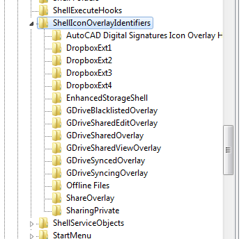

Yes I just rebooted to be sure.
Looks like I have 15.
Is your's the last 2, if so then it should work right?

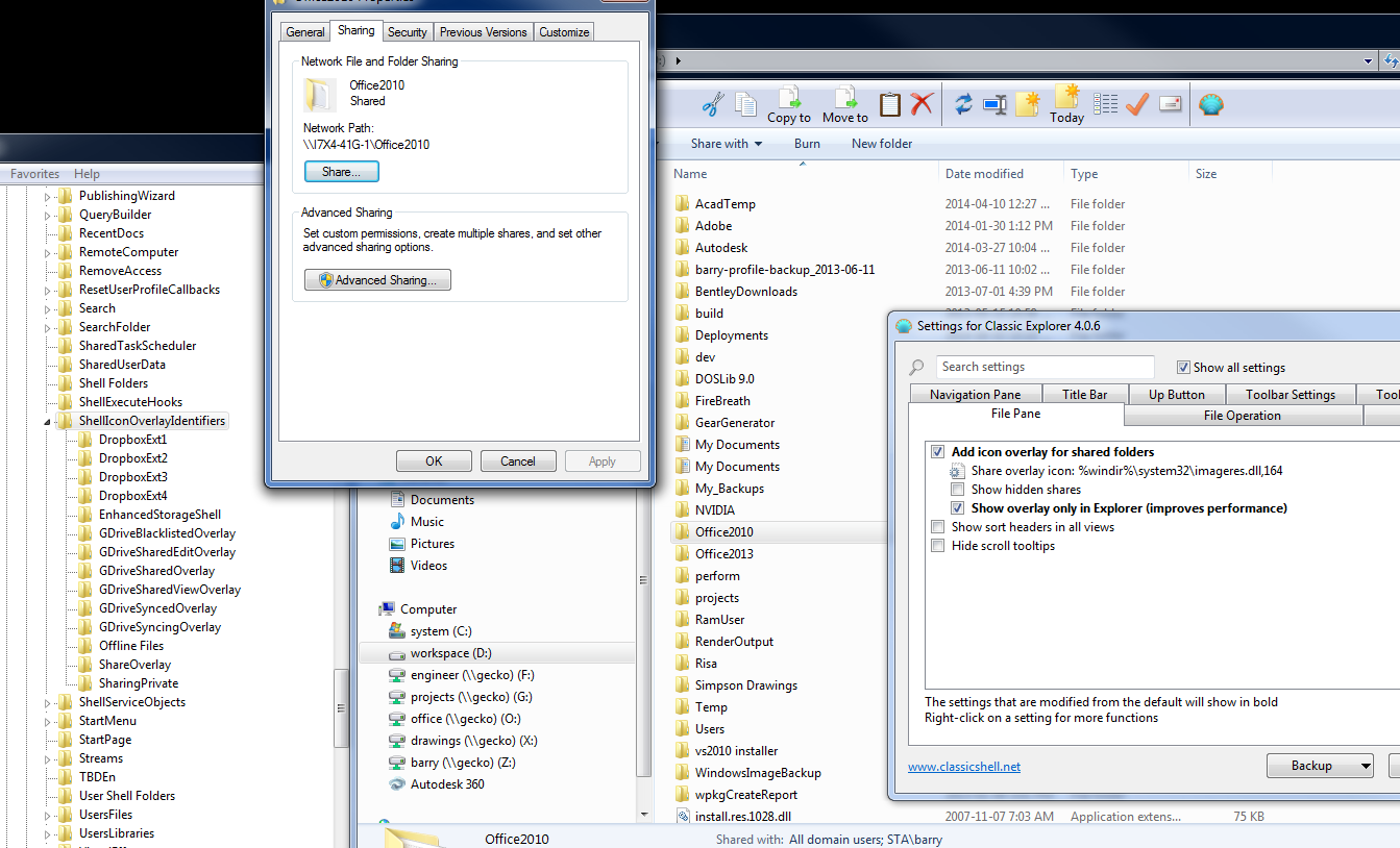

Only 'ShareOverlay' is from Classic Shell. SharingPrivate is a Windows built-in one that is shown when you click "Share with nobody". SharingPrivate is removed in Windows 8. You could try deleting the ones you don't need to see to bring the total count below 15.

Sorry still no go.
I deleted 1, so I now have 14, rebooted, & still not there...

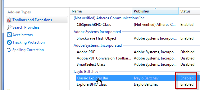

Try following the steps here: http://www.classicshell.net/faq/#explorer_toolbar to make sure all Classic Shell addons are enabled in IE Options.
PostPosted: Wed Apr 16, 2014 2:00 pm
Joined: Tue Apr 15, 2014 10:55 am
Posts: 6

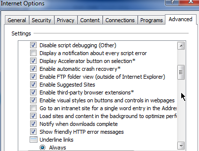

Grrrr, still no luck.
Yes the IE add-ons are enable & 3rd. party too.

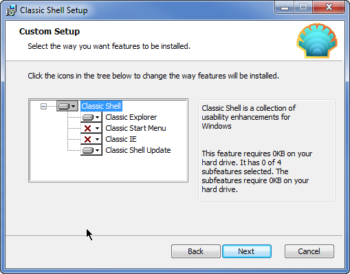

Could it be because I didn't install Classic Start Menu?
