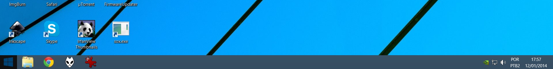

My classic shell keeps halting.
I suspect it could have anything to do with "going straight to desktop" before the standard start screen finishes loading up.
This is how it halts... anyone experiencing the same thing?
Check image attached.
classic_shell_halt.jpg [73.49 KiB]
Downloaded 6534 times
