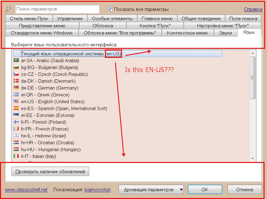

I have problem with correct interface language selection (not detection) with CS 4.0
Correct language is detected properly, but displayed wrong.
Windows 7 64bit prof English with MUI (russian). See attachment for explanation.
PS. If I forcibly set language to EN-US - everything becomes fine.

1. Nope. it's "current os language (en-us) - take a look at screenshot (if we're talking about CS settings). If You're asking about profile settings - it's en-US again :)
2. Nope, current OS language is russian (not user, but OS)
3. Russain
4. English (i know about win+r and a little bit more :)
5. Very simple - HKEY_USERS\.DEFAULT\Control Panel\Desktop - PreferredUILanguages (REG_MULTI_SZ) - "ru-RU"
You can also look to HKEY_USERS\.DEFAULT\Control Panel\Desktop\MuiCached - MachinePreferredUILanguages - i have "ru-RU" there also :)
And here: HKEY_USERS\S-1-5-18\Control Panel\Desktop - PreferredUILanguages (REG_MULTI_SZ) - "ru-RU"

OK, so the issue seems to be that everything in the OS is in English (Windows start menu, Win+R box, etc), Classic Shell correctly identifies the current language to be en-US, but for some reason the settings and the classic start menu are in Russian.
And you want everything to be in English.
Is that correct?
PostPosted: Thu Oct 24, 2013 9:51 am
I think his issue is that the settings dialog shows the language in Russian as expected but in the brackets (en-US) when it's in fact Russian?
Btw dfdf, you do mean you changed the language by directly editing the registry and not using the Control Panel? In that case, can it be possible that some additional setting doesn't get changed which is why Classic Shell continues to say it's en-US?
Is that correct?
Hurrau! That's exactly what I wanted to say in my very first post :)
