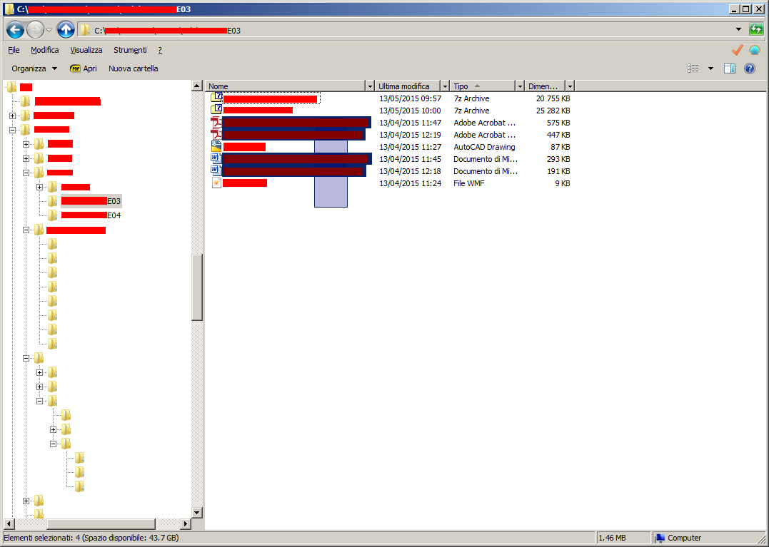

The "fig_1" shows how I view the contents of most directories.
It's more or less what I wanted. The selection mode is not "full row select", so I can easily select the files with long names, like I'm doing in the picture (the mouse arrow was not captured, but the light blue selection rectangle was, and four long-named files are selected...)
This feature is very useful for some works I usually have to perform.

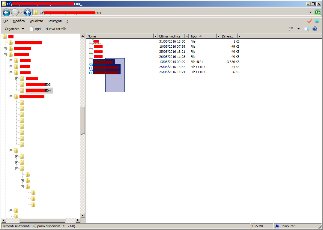

Unfortunately, some directories are shown in a different way: the example is in "fig_2". As you can see, the files are represented much more spaced (very annoying, when there are a lot of them) - by the way, also the bar with "Nome", "Ultima modifica", "Tipo", etc. is higher.
And the selection mode is "full row select" (making the work much harder).
So, what happens in the second directory?
I have verified that it doesn't contain any special hidden files (like "desktop.ini" or similar), it hasn't special attributes nor permission.
It looks like the behaviour actually depends on the directory name.

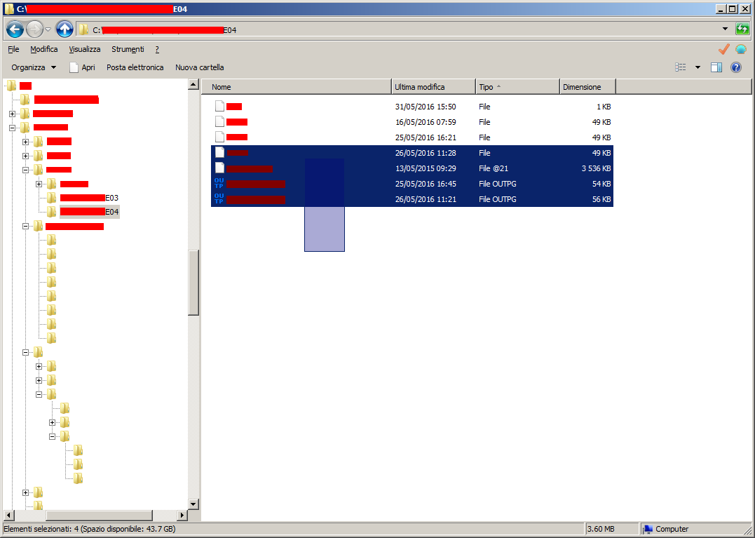

In the "fig_3", I have just renamed the "buggy" directory adding an underscore at the end (as shown in the title bar on the top and in the tree panel on the left - the address bar remained unchanged... a minor bug, maybe, but it's not so important). And now the contents of this directory behaves normally!
