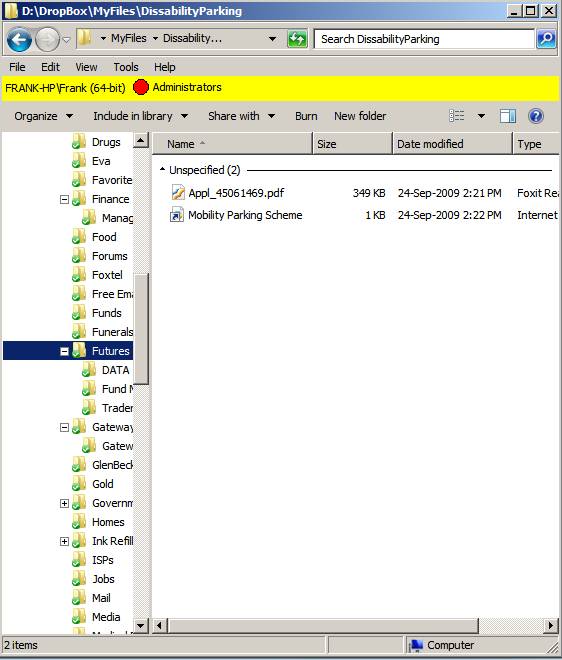

Attached is a screenshot of my explorer.
Yes I realise that the folder pane needs to be narrower than the text to show the horizontal scroll bars.
Thanks
Edit: Just noticed, when I try to horizontal scroll with the mouse (2 fingers left or right), the folders pane does not move. The file pane works fine.
