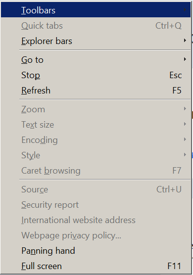

For me, pressing Alt+V did not open the View ribbon. Instead, it opened the drop-down menu attached below.
I selected "Toolbars", since that seemed to be the closest thing. The entry for the "Classic Shell Bar" did appear, but was unchecked. I clicked it to "tick" it; but nothing changed on the screen. I opened the menu again, and CS was still unchecked! Tried this several times; but something would not let me "tick" the Bar. I figured this was probably a problem!

Your screenshot shows that you are opening the View menu of Internet Explorer. In Internet Explorer, Classic Shell does not add a toolbar. It restores the page title to the title bar of IE and puts back the page loading progress indicator, and other information to IE's status bar. To turn on IE's status bar, press Alt+Space in IE's main window, and check the "Status bar".

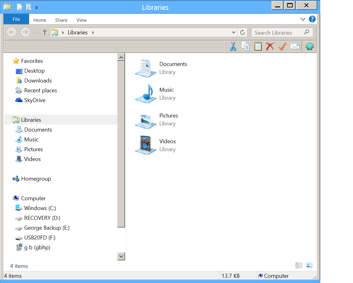

Let me clarify something: the problems I am experiencing are with INTERNET Explorer (not FILE Explorer, as far as I know. I have attached a screen shot of what the File Explorer window looks like.) I also just realized that the problem I'm experiencing may have to do with a THEME that I installed around the same time as CS; I'm just not sure who's doing what. (Aside to Gaurav: belated thanks for the Theme you posted for me. I later found this one:

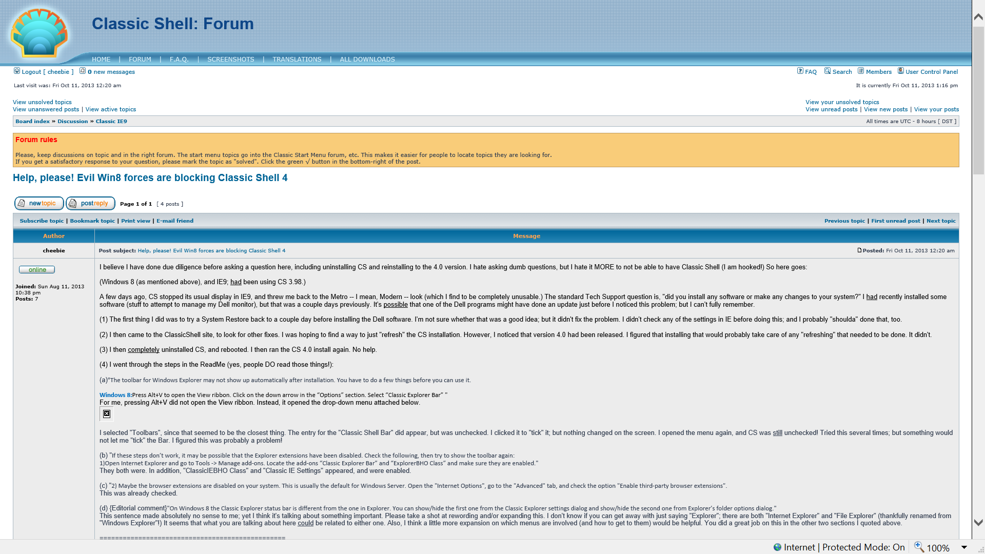

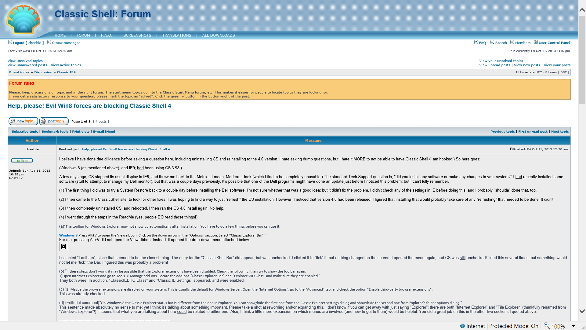

I have also attached a screen shot of what IE looks like when I open it (and please let me know if you would prefer a different graphics format, etc.) Problems:
(1) There is no "tab bar" or other toolbars at the top. Previously, these bars ALWAYS appeared, and were in a format similar to what I used to see in Win XP (using the "Classic" Theme for XP, not the "XP" Theme, if you know what I mean.) If I push my mouse cursor up to the top of the screen, a toolbar of sorts appears; but it seems to come and go of its own accord. And when it is there, it covers up part of the web page (often, the important navigating features are at the very top!) This toolbar does NOT look like the one I had before. With regard to the "covering up", I think there may be some issues here with parts of Classic Shell still loading and working.
(2) The Task Bar at the bottom goes away when I go into IE. Previously, this would stay in place when I opened an IE window. In response to Jcee, I do have the Classic Shell Start button, when I have the Taskbar!! But no Taskbar in IE, etc.
For these reasons, I believe (in response to Ivo) that I have been kicked back to a Metro look.

- You said: "To turn on IE's status bar, press Alt+Space in IE's main window, and check the "Status bar"." I did try that, and got a menu of "toolbars" that seemed appropriate (again, I apologize if I am not quite calling things by their correct names.) The Status Bar is checked. However, an entry for "Classic Explorer Bar" also appears, and it is not checked. When I click on that entry, it does not get "ticked", and it seems like that might be part of my problem. Then again, given what you said above about "Classic Shell does not add a toolbar..." - I don't know what to think.
PostPosted: Fri Oct 11, 2013 6:29 pm
Looks like your Internet Explorer was closed while in fullscreen mode. This is not the same as Metro mode.
Try pressing F11 to go back to normal.

Gack! GACK, I say!!! :oops: :oops:
I just KNEW it was a stupid problem/question!!! I have NEVER used "full-screen mode" in ANY version of Windows, so I wouldn't know it if I saw it (and obviously, I didn't!)
You gotta admit, though: it DID kinda look like a Metro app, didn't it? No toolbars, no Taskbar, annoying behaviors ...
