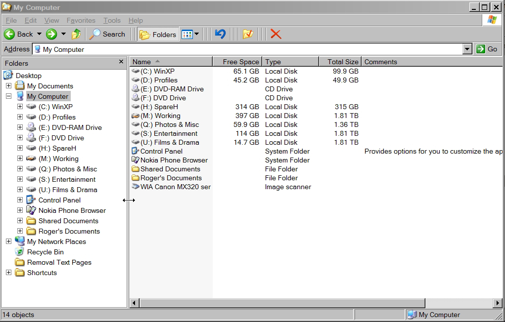

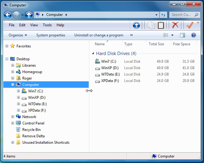

I enclose a couple of screen-shots - one from XP and one from Win7.
In each image, my mouse is just in the correct position to grab the vertical divider, so the mouse icon has changed to a small horizontal line with arrows on either end. (Sorry, I don't know the technical name for it).
I would estimate that the "XP Windows Explorer" line has a vertical region about 5 or 6 pixels wide for grabbing, whereas the "Classic Explorer" line is maybe only 2 or 3 pixels wide. You can actually see how much thinner the line is in Classic Explorer.
Whatever the numbers are, I find it quite hard to reliably grab that divider with my mouse pointer.

File comment: Windows 7 Classic Explorer
File comment: XP Windows Explorer

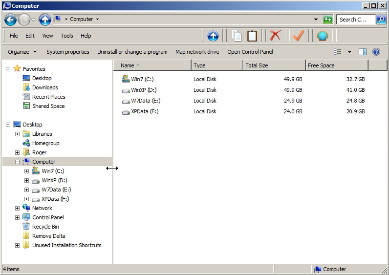

I just tried the "Windows 7 Basic" theme and the thin divider is still there - see image below.
Can you suggest a theme where the divider is wider and easier to grab?

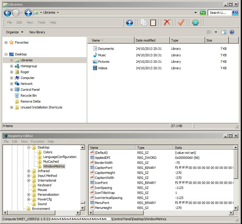

Update on this issue:
I used "RegShot" from SourceForge ( http://sourceforge.net/projects/regshot/ ) to determine which key(s) change in the registry when I change the Active Border Width in Windows XP. This Active Border Width setting also changes the width of the divider between the Folder pane and File pane in Windows Explorer on XP.
The setting that changes is:
HKEY_USERS\S-1-5-21-123456789-123456789-1234567890-1003\Control Panel\Desktop\WindowMetrics\BorderWidth
(I changed the numbers after S-1-5-21-, in case that would identify me to Microsoft).
The Active Border Width can be changed in XP by going to Control Panel / Display / Appearance / Advanced. Use the drop down box to select "Active Window Border".
When the border is width "1', the key value is "-12".
When the border is width "2', the key value is "-24".
When the border is width "3', the key value is "-36", etc.
This key is also present in the registry of Windows 7, so I was hopeful that I could change it to produce the same effect in Windows Explorer on Windows 7. No such luck.
I also discovered that there is a way to adjust this setting without going into the registry: Control Panel / Display / Personalization / Window Color. Then use the drop down box to select "Active Window Border".
When the border is width "1', the key value is "-15".
When the border is width "2', the key value is "-30".
When the border is width "3', the key value is "-45", etc.
So, Windows Explorer in Windows 7 does not use the Window Border setting when drawing the line between the Folder pane and the File pane.
But, guess what DOES use the Window Border setting... "regedit"! Yes, they screwed up Explorer but, thankfully, kept their sticky little fingers away from the "regedit" code. So "regedit" has a nice thick / adjustable divider which is easy to grab, but Explorer - which needs it much more - doesn't.
