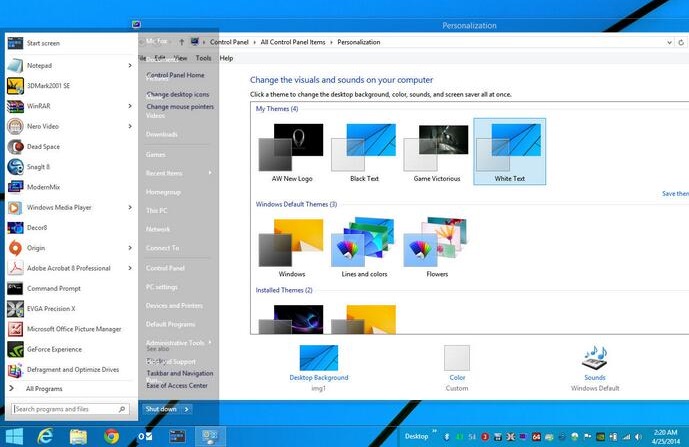

Just as an example, this is the unreadable mess that you can get when there is too much transparency. You don't want that! :lol:
