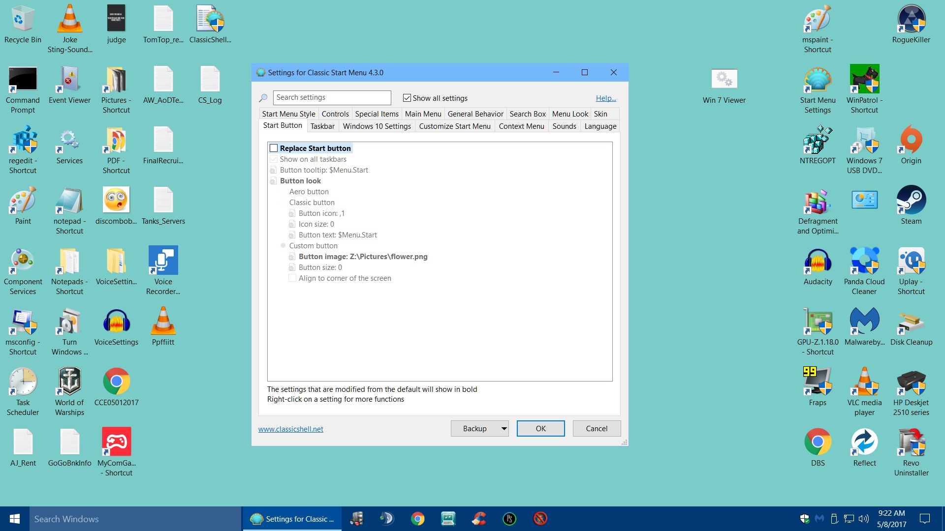

Each time I restart the PC I get a Classic Shell window that I must click 'OK' in order for it to run.
Enclosed is a screen shot of said window plus the CS_Log file for someone to look at. This window never appeared previous to my repair of the startup application(see Bug Report of Creators Update Issue)
Thanks in advance.

Your Startup folder contains a shortcut to ClassicStartMenu.exe with the -Settings parameter. Here's what you need to do to fix it.
Press Win+R keys together to open the Run dialog.
Type the following in the Run dialog:
shell:startup
and press OK/Enter.
The Startup folder will now open.
Right click the Classic Start Menu shortcut and click Properties. It will open with the "Shortcut" tab active.
From the "Target" field, remove the "-settings" part and click OK so instead of:
"C:\Program Files\Classic Shell\ClassicStartMenu.exe" -settings
the target should become:
Click OK to close the Properties.
Now, the window will not open at startup.

I thought about it before your response Gaurav and removed the startup short cut in user>(my name)>app data>roaming>microsoft>windows>startup>programs ( i think that is the right sequence) but you know what I'm talking about. That stopped the window opening upon each restart.
When I ran the shell:startup in Run mode I got an error message ''windows can not find shell startup''
wonder why that is when the app clearly starts.

It looks like you copied the Settings shortcut to the Startup folder by mistake.
Try opening C:\Users\<your user name>\AppData\Roaming\Microsoft\Windows\Start Menu\Programs\Startup and then modify the shortcut. The rest of the instructions are the same.
