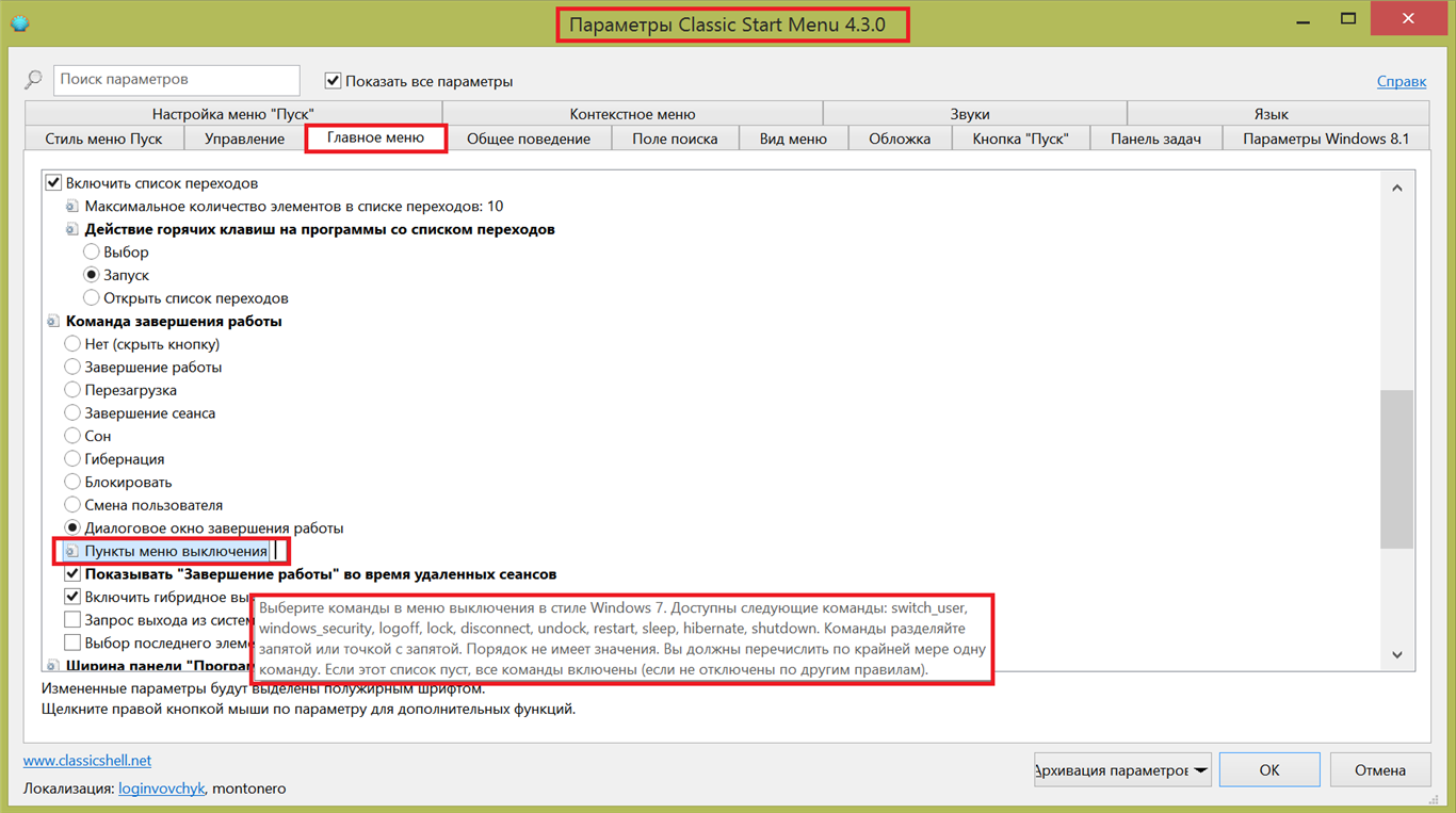

Follow these steps:

Ok! Yes! Happened !!!!
Thank you so much!
