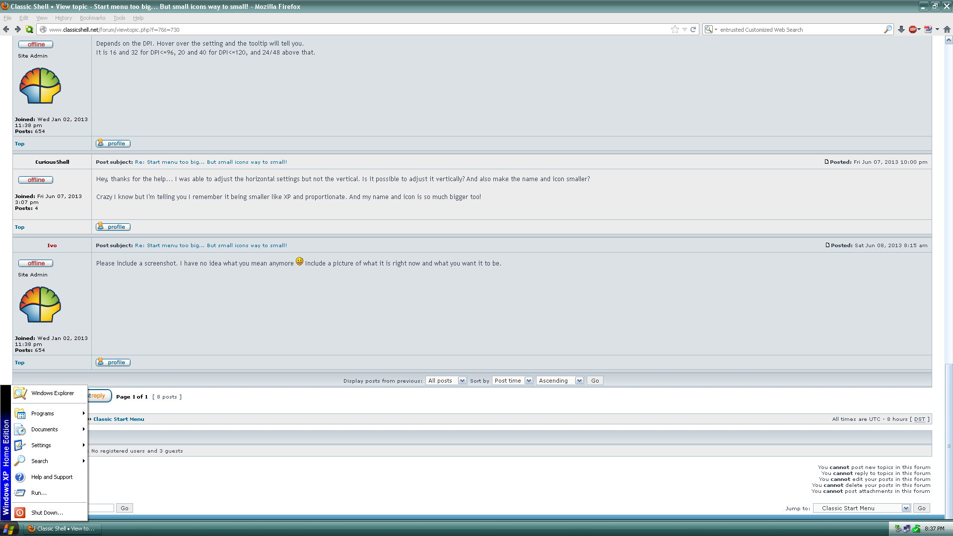

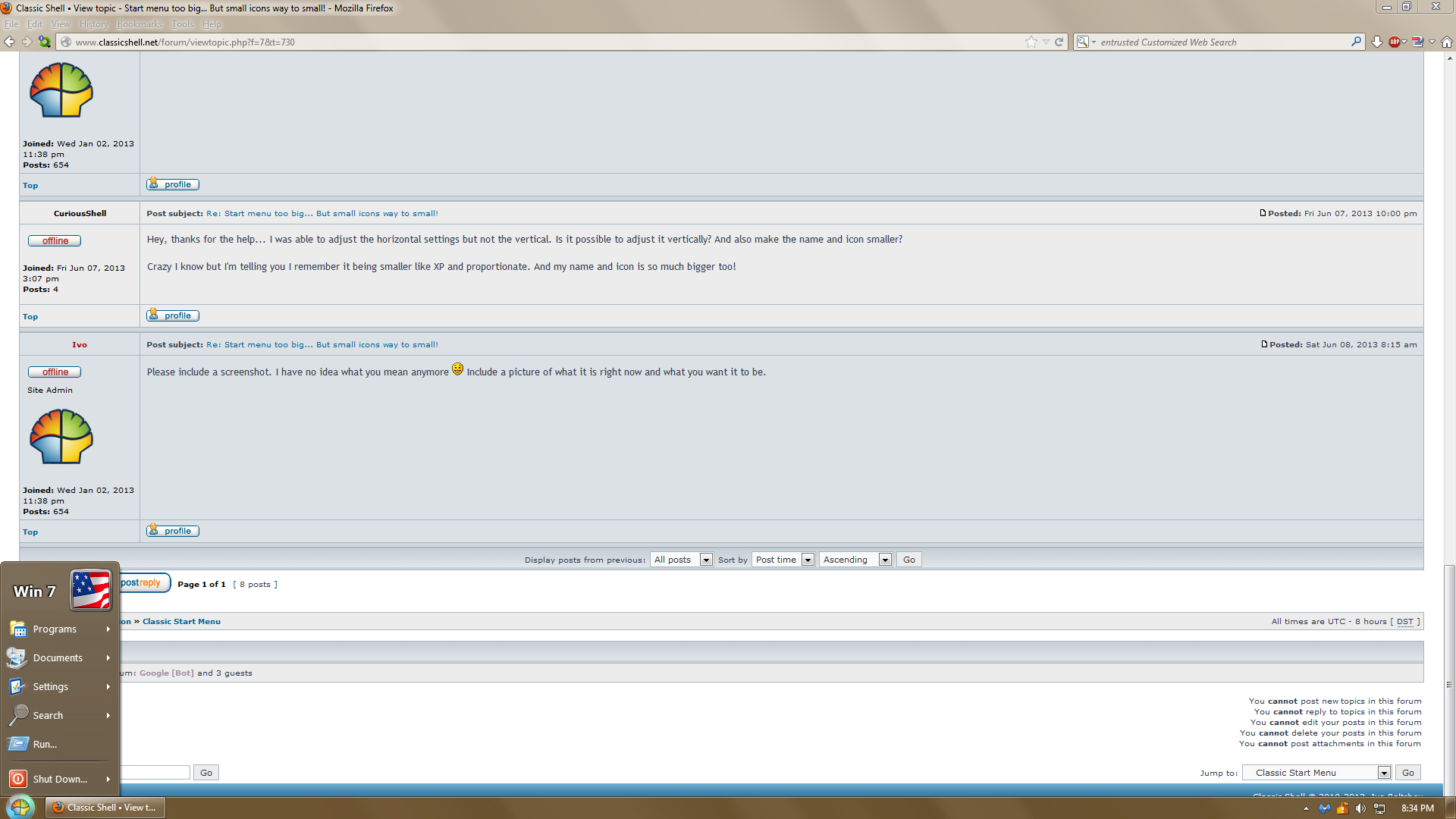

Hey, thanks for the help... Attached are two screen shots, one from the XP desktop and one from the 7 laptop.
Hopefully you can see the difference... And again, I know this is crazy, but if it can be fixed I'd like to at least try... But I still remember doing something!

PostPosted: Sat Jun 08, 2013 5:56 pm
The Classic Shell menu has more padding around the items to allow for the more intricate selection highlight. Also Windows 7 uses a different font than XP (Segoe UI vs Tahoma). Both fonts have different metrics.
If you want to get the EXACT style menu as XP you will have to edit the skin yourself. The setting you need is Main_icon_padding. By default it is "3,3,3,3", which means to add 3 pixels on each side of the icon.
