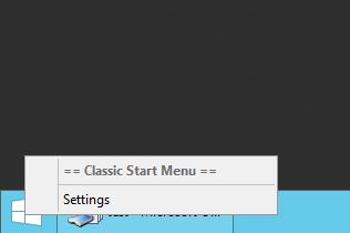

Hi ,
How to remove or disable right click settings menu from Classic shell? Please see the attached.

PostPosted: Wed Oct 19, 2016 7:48 am
There is a Registry DWORD value supported in HKLM\Software\IvoSoft\ClassicStartMenu called "EnableSettings". Set it to 0 to fully disable the Settings dialog. Log out for the change to take effect.

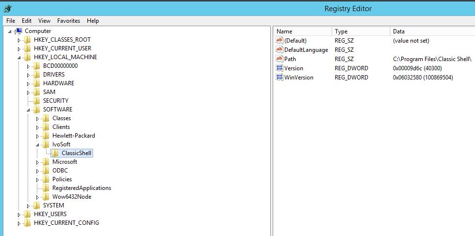

Posts: 26
Thank you for your prompt reply. I don't see ClassicStartMenu called "EnableSettings". in our Reg. Please see the attachment.
PostPosted: Wed Oct 19, 2016 9:24 am
You need to make a new key for that.
