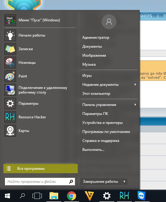

Windows 10, Classic Shell 4.2.5, Metro skin.
I have a problem that I can't solve. This swampy green color is disgusting. I found no option to change it. Help me please.
PostPosted: Mon Jun 20, 2016 3:40 pm
What you are looking for is "Highlight newly installed programs"
The green itself cant be changed without modifying the .skin or .skin7 file
PostPosted: Mon Jun 20, 2016 6:58 pm
Joined: Mon Jun 20, 2016 2:49 pm
ThANX a lot!
I've replaced $StartInlineErrorText variable on $StartRoundButtonHover at 4 places in Metro.skin7, so new color is suitable for me.
I haven't understood how to work with mask, so made changes to variables only.
Thanks again!
The result is in attachment.
