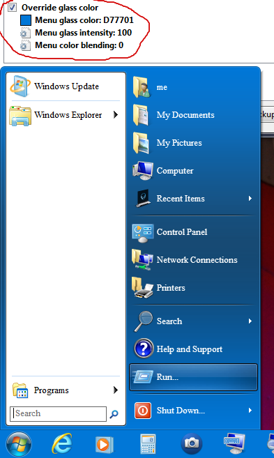

The color is more saturated. What I could do is increase the color mask to the maximum at the top and bottom,
and then you can go to the "Menu Look" tab in CSM settings,
check the box for "Override glass color" and
enter D77701 in the "Menu glass color" rectangle area.
That will make the menu have your special blue color.

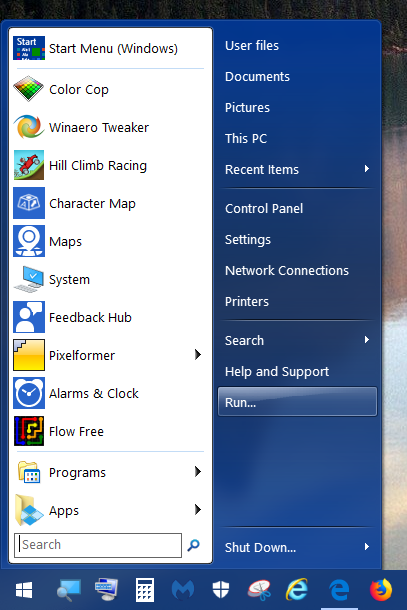

Update: I modded the newer Windows Aero skin.
I only added some of your font text, added opaque menu option that has 255 max color on bottom and top of color mask.
Matching color works with opaque taskbar setting and opaque skin setting, along with menu glass override color settings. See picture.

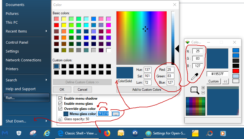

Here is a screenshot of Windows Aero Opaque Mod.skin on Windows 10 with your new color.
If you did not know, if you input a hex color into the box it has to be bgr not rgb
Here I switched to Open Shell ver 4.4.131
The bottom of the menu and taskbar match exactly r25,g83,b127
Works for me. Make it pink if you want. Will still match. :lol:
