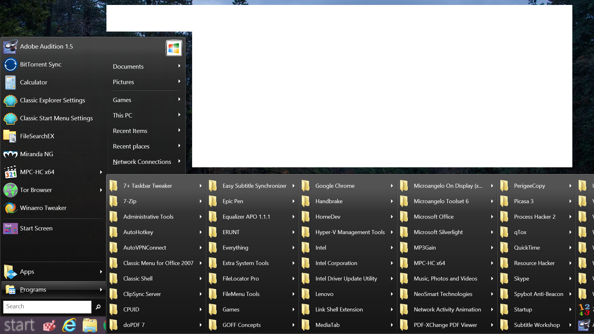

PostPosted: Thu Apr 28, 2016 1:46 am
The menu cannot be closed by clicking in the white region (marked in the attached image). While you can split it that way into multiple columns using transparent padding, the only benefit is that you get to see what's behind it. The menu still occupies the area of the screen marked by the white region but you are only hiding it by making it transparent. This is different from actually making the menu not take up that space at all. That's what I meant by "not possible". Technically, you can create a 1 row submenu too with the rest of the area transparent. :D

PostPosted: Thu Apr 28, 2016 9:19 am
Did you try the clear one? the clear one is 100% click through...
PostPosted: Thu Apr 28, 2016 10:43 am
I tried Smoked Glass2a.skin. It is see-though but the submenu doesn't close for me in the area which I pointed out in Region.png above. How can it? :) It can't because it's transparent, it's not like you modified the Start Menu code to not render it in that area. :)
PostPosted: Thu Apr 28, 2016 11:07 am
Well it does close for me....? :P (I did it while posting just to be sure)
I expected that was default behavior.. and discovered it when making my aero glass skin years ago (the top 100~ pixels are transparent)
I'm pretty sure it did back on windows 7 too? but I cant/wont confirm...
Im just curious; does right clicking a fully transparent part of your start button, yield the win+x menu? (assuming right click isnt set to-to so) For me it does
Left click used to aswell, but I remember IVO explicitly fixing that for usability sake... (and I agree with that decision)
