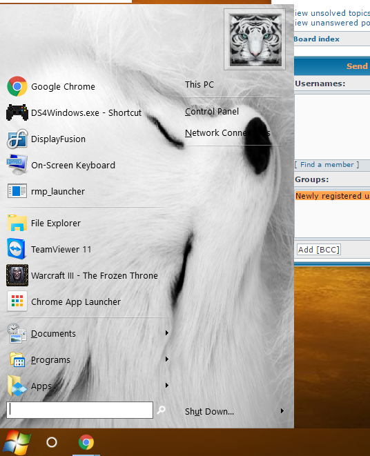

PostPosted: Sat Jan 30, 2016 4:56 pm
Posts: 29
To Jcee's attention;
PostPosted: Sat Jan 30, 2016 10:36 pm
Looks to me like your new picture has an alpha channel... have you tried re-saving with Ms paint before import?
If you need, I can format this image too... Just attach it here
PostPosted: Sun Jan 31, 2016 1:24 am
Posts: 29
I tried with three diferent pictures, always same. Yes I tried re-saving with Ms Paint too.
I need to know what is really happening. Please tell me about processes of editing step by step if possible.
Have a nice Sunday..
Picture: http://i.hizliresim.com/knQVDq.jpg
Or another picture with png format: http://i.hizliresim.com/m1bv9Z.png
PostPosted: Sun Jan 31, 2016 12:21 pm
Step by step from the jpg
1 dowload latest stable https://www.gimp.org/downloads/
2 right click the image, and select open with find gimp
3 OPTIONAL Go to Image>Scale image and make the height 786, allowing the width to scale accordingly
4 OPTIONAL Go to Image>Canvas size and crop the image to 666 width
6 Check Compatibility Options: 'Do not Write color space information'
7 Check Advanced Options: "16 Bit X1 R5 G5 B5" Then click Export
8 Locate this image in explorer, right click and select edit (This should open it in MS PAINT, otherwise go to open with, and find PAINT)
9. Hit the Save icon then exit paint
10. Locate your image in reshacker, and replace resource 31 then save
PostPosted: Sun Jan 31, 2016 3:25 pm
Posts: 29
Yes, Gimp is the solution, thank you for help.
