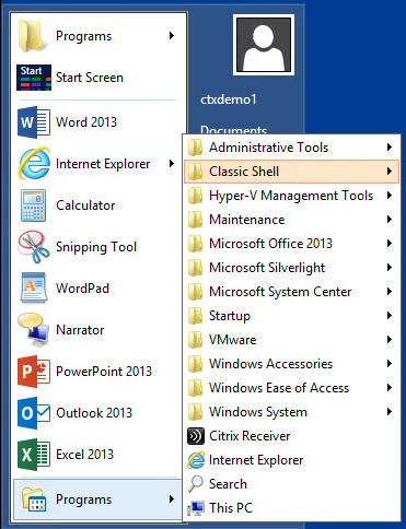

I'm currently trying to set up a Classic Start Menu for a Citrix published desktop based on Server 2012.
I have installed Classic Shell onto the Windows 2012 Server and put the ADMX files into the right folder, GPMC is picking up the additional files no problem
I have a GPO that is applied to an OU that contains only user accounts and am making changes to the policy in the User Configuration section only.
Menu Style is Classic with 2 columns
I want to redirect all users start menu to c:\programdata\Microsoft\NewUserMenu and have set this under "program folder"
I also want an option to log off (but not shut down etc) in the start menu and have enabled "show Log off"
But what I am getting is no log off option, and two program folders, one contains just start up, the other contains C:\ProgramData\Microsoft\Windows\Start Menu
Please can you let me know what I'm doing wrong?

 Post subject: Re: GPO Help please
PostPosted: Wed Oct 21, 2015 8:50 am
You have redirected the user's Programs folder but not the user's Start Menu folder. As a result, the "Start Menu\Programs" folder is considered a plain folder like any other and shows up as a sub-menu.
You need to change the "Start Menu folder" setting instead of the "Programs folder" setting.
I don't know about the log off. It is obscured on your screenshot. I need to see how it looks now.
PostPosted: Thu Oct 22, 2015 6:09 pm
Joined: Mon Oct 19, 2015 9:42 am
I have changed the start menu setting to look at a folder which contains the start menu structure, but it's still showing the wrong icons. (C:\ProgramData\Microsoft\Windows\Start Menu)
I am a little confused by the difference between the settings defined in "Menu items for classic menu with x columns" and the rest of the settings defined by the GPO, if I have both set, will that cause a problem and which take priority?
