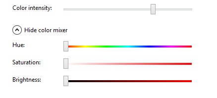

I found the solution I WANTED. I know I said I Give Up, but I am also somewhat OCD so this problem gnawed at me all day.
Here is how I solved my problem and finally got what I wanted since the beginning.
In the Bug Reports section of these Forums there is a thread named: Task Bar Color Incorrect - ClassicShell 3.6.6
The User bobdukes (second reply, third post) described how he solved his problem. I did a similar tweak, so here goes:
1- Changed Windows Theme to Windows. (and saved)
2- Changed my Background Image to my Black.jpg as before.
3- Changed Color settings to Color 1 (dark gray)
4- Tweaked additional Color settings as in image below.
5- Classic Shell Option: Start Button = Disable Taskbar Transparency (UN-Checked).
6- Switched Classic Shell to Smoked Glass and VOILA!
My menus are Black, my Taskbar is Transparent Black and the Clock/Date/Keyboard sections are Whitish as I wanted.
Thanks to all, this does it for me. I am happy now even though I still Hate Win8.
