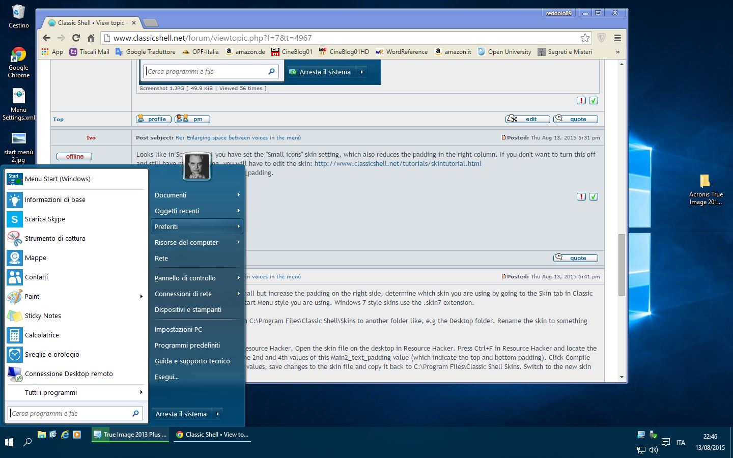

My goal is to increase the space between the voices in the menù (screenshot 1 is my menù). As you can see, they are compact there with little space between each other (sorry for the ugly arrows)

Looks like in Screenshot 1 you have set the "Small icons" skin setting, which also reduces the padding in the right column. If you don't want to turn this off and still have more padding, you will have to edit the skin: http://www.classicshell.net/tutorials/skintutorial.html
Look for a setting called Main2_text_padding.

I tried to use large icons and also large font. The result is in screenshot 3. It definitely looks bigger, but still not as much space as the screenshot 2, also because i would really like if possible to keep the icons small (but still big spaces).
