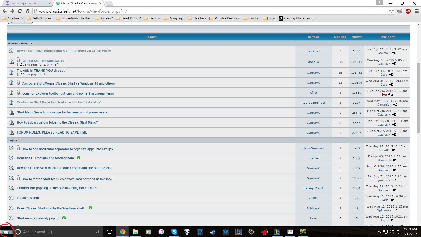

I cant seem to get the icon to fit vertically. I have used a few different images but the same thing happens? What do i need to do? I am on windows 10.
File comment: Icon photo
Untitled.jpg [337.22 KiB]
PostPosted: Thu Aug 13, 2015 1:06 am
Which Start menu button image are you using? It needs to have 3 states - for normal state, hover state and pressed state. Like this: http://www.classicshell.net/tutorials/b ... orial.html Also the width of the image is the size of the button. You can override the size from the "Start Button" tab in Classic Start Menu settings.
