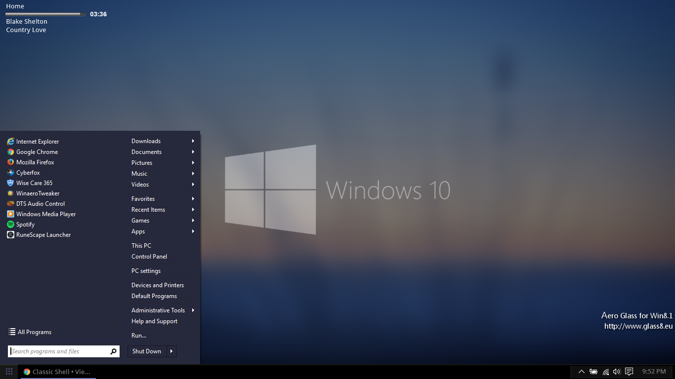

Hi Guys. I've done a search for this but couldn't find any answers, so I'm hoping someone here can help me. I'm after upgrading to Windows 10 from Windows 7 and since I didn't like the Windows 10 start menu very much I decided to try Classic Start Menu. I went through most of the default skins and I really fell in love with the Windows 7 style Metro skin, it's just really clean and easy to manage. Here's how it looks for me right now:
My only issue is that I'd love to get the background of the menu to be the same darker blue color of the taskbar, but unfortunately the Menu Glass Color option in settings doesn't change the color on this skin for me. I've looked around inside the skin file using Resource Hacker but I can't seem to find any particular line that I can edit to change the color. Anyone have any ideas?

The background is set by lines like this:
Main_bitmap=$StartBackground
That means the main menu background will use the start background color. The taskbar uses the $SystemAccentDark2 or $SystemAccentDark3 color depending if it is transparent or not. You can try changing the menu to
Main_bitmap=$SystemAccentDark2
However, the selection also uses SystemAccentDark2, so you'll have to change that color as well. For example
Main_selection=$StartSelectionBackground
BTW, those are just examples. You will have to change multiple lines in the skin because the same colors are used in multiple places.

Wow, thanks for the quick reply, I made a donation so you can get yourself a pint on me :) My desktop is looking great now!
