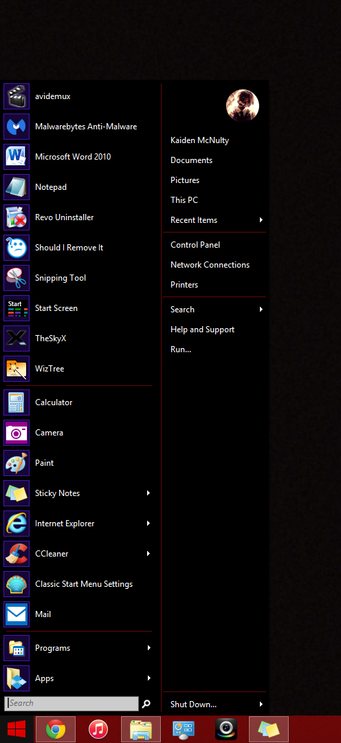

Hi, I hope someone can help me.
So my classic shell start menu is completely the way I want it - except for one thing.
I like having the icon frames on the start menu enabled. But the colour of the icon frames don't match my colour scheme on my start menu.
I have a black and red start menu but then the icon frames are purple. It's annoying.
Check it out in the attachment below. I want the icon frames to be red to match my colour scheme.
I've been trying to figure out how to change the icon frame colour for so long but have found no answer.
Please help.
Cheers,
Kaiden

The color of the frame comes from this line in the skin:
Main_icon_frame_tint1=$StartDesktopAppBackground
You can change it to a specific color, like red:
Main_icon_frame_tint1=#FF0000
