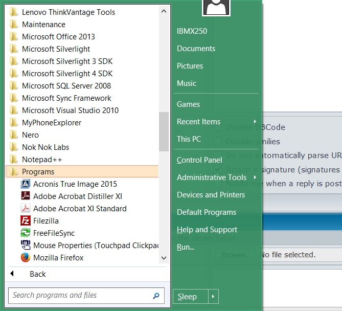

When I installed Classic Shell on my new Lenovo laptop, something odd happened, and I don't understand why.
When I press the Start button, and then All Programs, then scroll through the list of programs, at the top there are some shortcuts to individual exe files, then later there are program folders. This is perfectly normal.
What is not normal, is that in the list of installed programs, there is a folder labelled Programs, and inside that folder, the list of individual EXE files (shortcuts) repeats and shows the entire list of installed programs and there folders again. It is recursive.
Why is this happening? It did not occur on my other Windows 8, upgraded to 8.1 machine.
I've attached a graphic illustrating the problem.

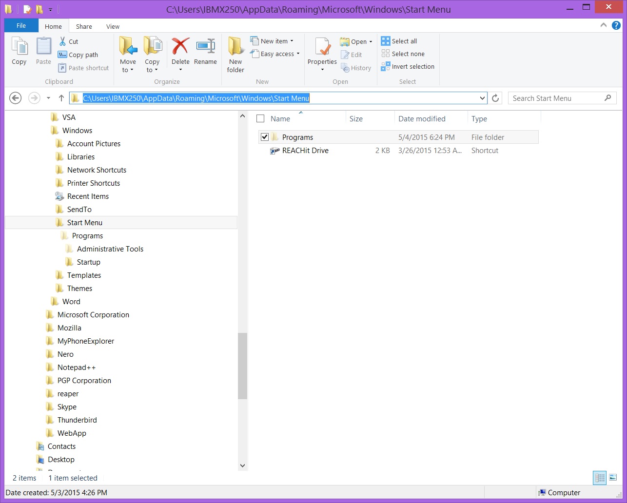

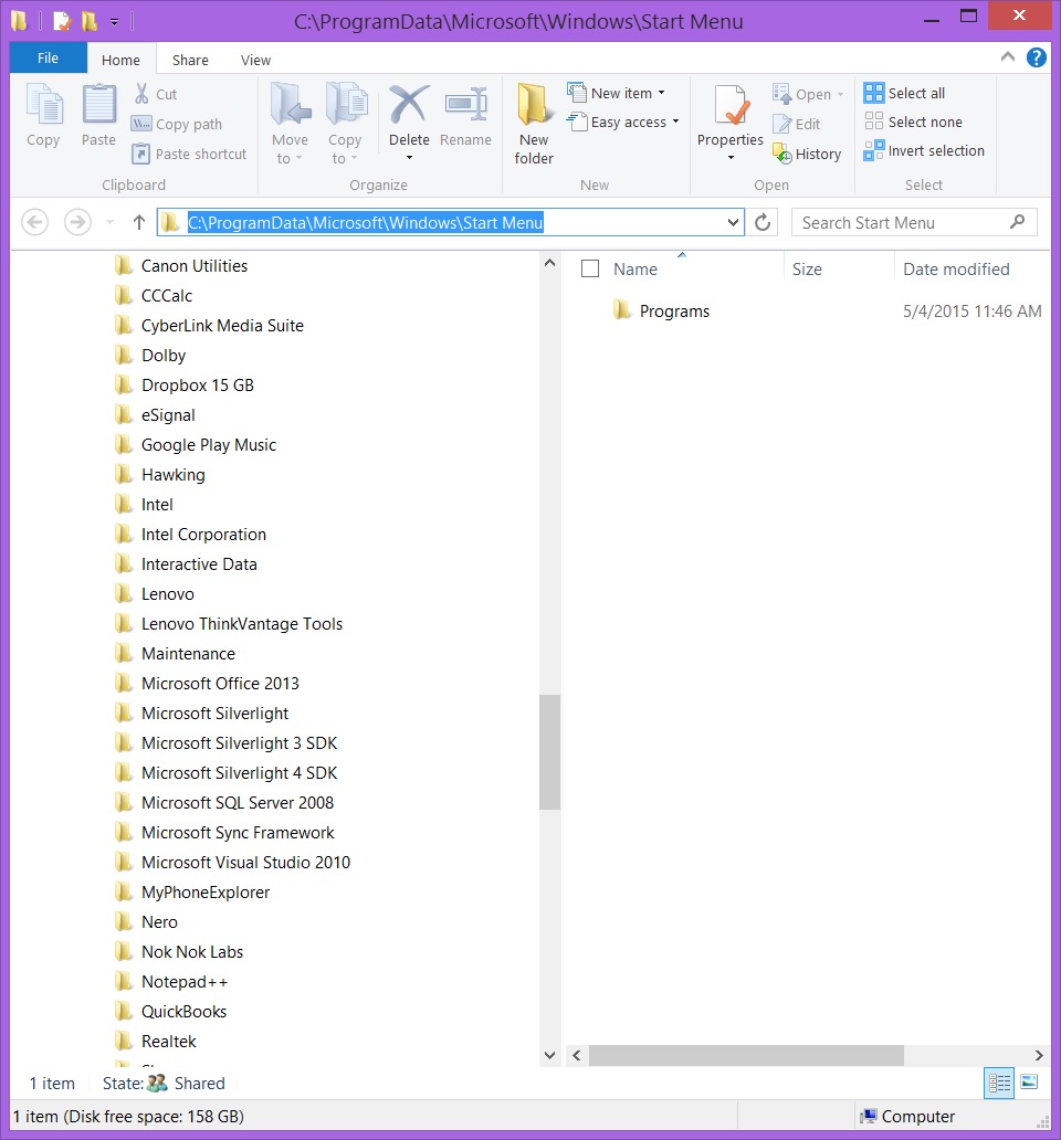

You would think that would be the problem, but it doesn't seem to be. There is only one programs folder inside the user menu folder structure, and likewise for the all user menu structure. See the attached graphics for confirmation.
Any other ideas?

Also Classic shell pulls from 2 directories:
C:\Users\[USERNAME]\AppData\Roaming\Microsoft\Windows\Start Menu\Programs
and
C:\ProgramData\Microsoft\Windows\Start Menu\Programs
Is there a folder labeled 'Programs' inside either one of those directories?
and is it fully recursive (Does this subfolder have a 'programs' subfolder of its own?)

When I noticed that there was a Programs folder inside a Programs folder, I deleted what I thought was the extra copy of the Programs folder, and recreated any shortcuts and folders inside that, which is why my Start menu looks fairly clean. However, part of the reason it looks clean is that I hid the Programs folder in the User menu.
Anyway, I note that currently, my user Start menu folder does have a location tab, but the Programs folder inside it does NOT. (Checking another machine, it DOES.) So, apparently, I deleted the system folder and replaced it with and ordinary one with no Location tab. So, how do I reestablish the system aspect of the user Programs folder and get the location tab back on it?
