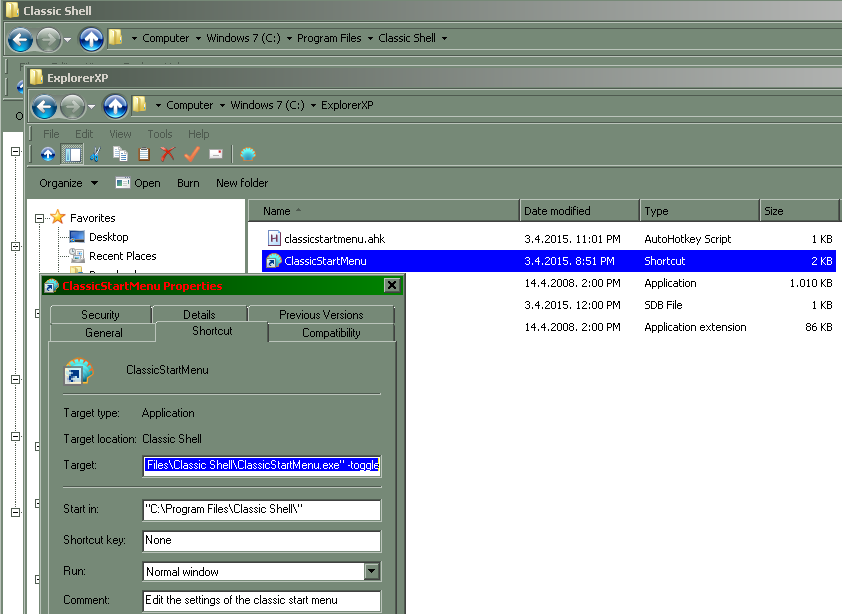

PostPosted: Fri Apr 03, 2015 5:21 pm
Joined: Thu Apr 02, 2015 10:33 pm
I do have right filepath, and it does not work.
You can try and recreate my situation, maybe you'll have more luck. :)
All you have to do is install SharpEnviro (http://sharpe.sourceforge.net/),
then in SharpE Shell Switcher select SharpE as shell and check Separate Explorer process.
Restart PC (Win7).
1. Try Win Key for open StartMenu
2. Try and run ClassicStartMenu with switch -toggle.
Tell me is it working or not... maybe my OS is more broken then I thought it was.
File comment: Picture shows properties of my ClassicStartMenu shortcut.
