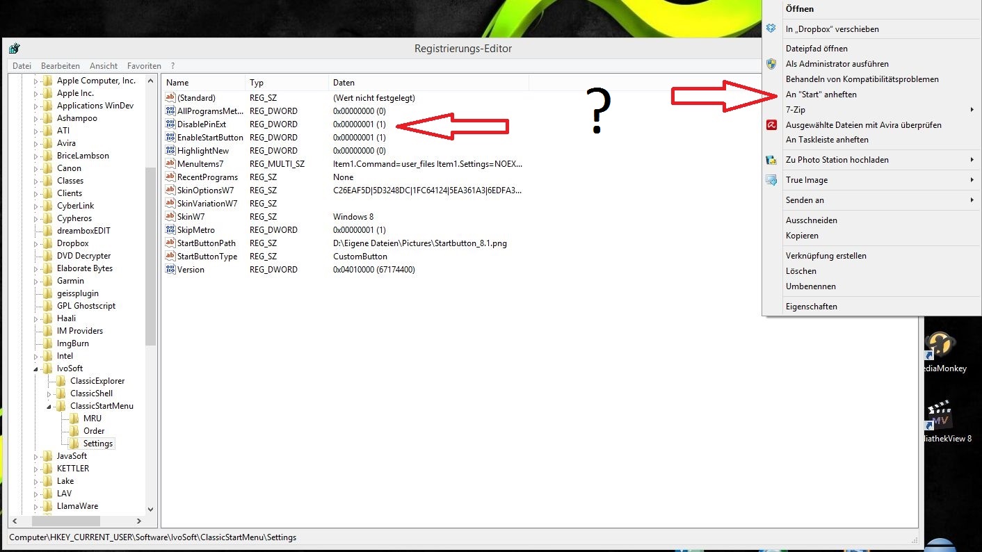

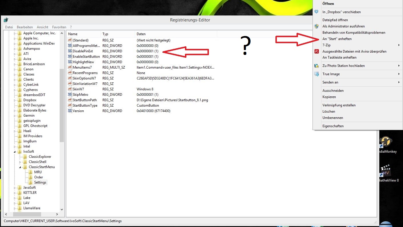

PostPosted: Sat Dec 27, 2014 3:00 am
Joined: Sat Dec 27, 2014 2:56 am
GauravK wrote:
In Classic Shell 4.0.4, there is a new hidden setting "DisablePinExt". Add a DWORD value of this name to either HKCU\Software\IvoSoft\ClassicStartMenu\Settings or HKLM\Software\IvoSoft\ClassicStartMenu. A value data of 1 hides the "Pin to Start Menu (Classic Shell)" context menu item. This hidden setting is present as a Group Policy setting too called 'Disable the Pin shell extension'.
I made the Registry Entry, but it had no effect (see attached picture)!?
I am using version 4.1.0.
What else can I do, to remove the "pin to start" entry from the start menu?
File comment: Correct?
Remove Pin to Start.JPG [215.97 KiB]
Downloaded 418 times
PostPosted: Sat Dec 27, 2014 11:17 am
First, if you are using version 4.1.0 or later you can just check the setting "Disable the Pin shell extension" in the Context Menu tab. No need to mess with the registry.
Second, the context menu command is called "An Startmenü anheften (Classic Shell)". The one you show belongs to Windows. Classic Shell has no control over it.
