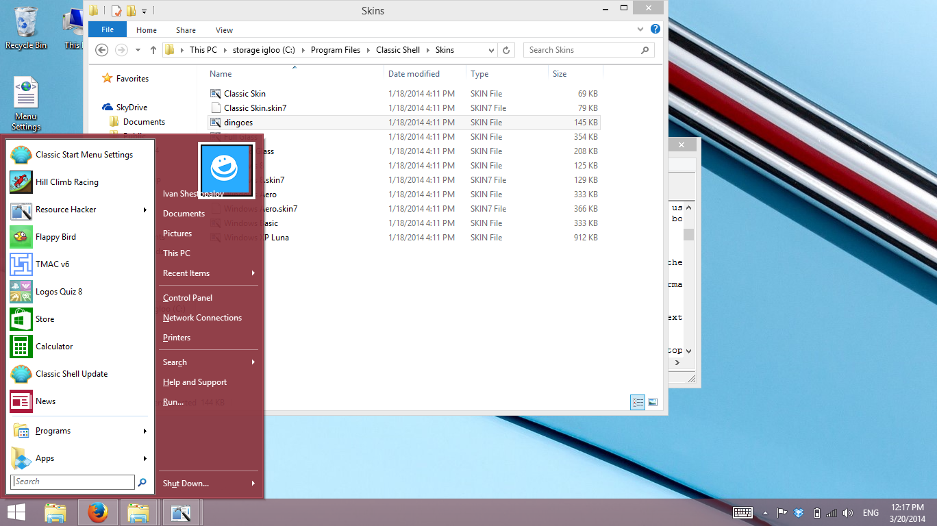

Ok, so I resaved the file under a different name and it worked, but now this happened:
Screenshot 2014-03-20 12.17.30.png [457.32 KiB]
Downloaded 1246 times
PostPosted: Thu Mar 20, 2014 9:42 am
You need to adjust the image offset and also the top padding of the second column (Main2_padding)

@GauravK Yea I managed to change the size, thanks for the offer. Now I need to change the offset/padding and see if that works.
PostPosted: Sun Mar 23, 2014 7:10 pm
Joined: Wed Mar 19, 2014 5:05 pm
Changed the padding, and everything works now! The only problem now is that the shutdown dialog doesn't include "sleep"
