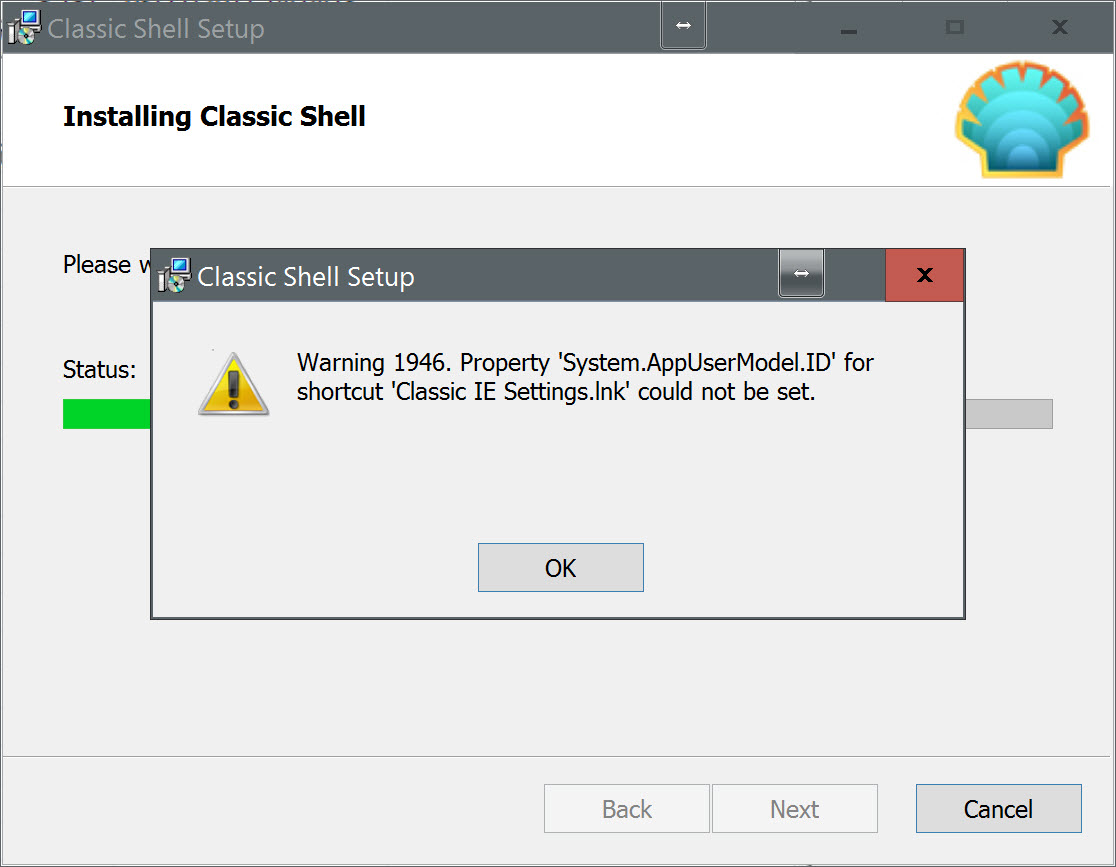

PostPosted: Thu Jul 13, 2017 11:27 am
Joined: Thu Jul 13, 2017 11:19 am
My new laptop came with Windows 10 Pro and I believe it is the Anniversary version.
I installed Classic Shell menu for the first time today but got an error message during install.
The programs seems to be working anyway so should I be concerned about this error?
PostPosted: Thu Jul 13, 2017 2:23 pm
I think you can disregard that. Was the installer running in some compatibility mode?
PostPosted: Fri Jul 14, 2017 2:34 am
No it wasn't although I did run it in admin mode.
My guess is it came up due to Edge being on my machine rather than IE.

DAOWAce wrote:
Nope, not fixed. Still hangs up at complete random when explorer.exe starts.
Seeing as I can't use Win7+ without classic shell (ui is so atrocious), I can't even troubleshoot to see if it's actually a classic shell issue.
Maybe it's my install of 10, maybe not, guess I'll never know.
Okay, seeing as it started to happen after nearly every damn login, I started to troubleshoot.
It is definitely caused by Classic Explorer.
I uninstalled and reinstalled the program after I randomly got this message after the issue happened today:
I tried installing only classic explorer; issue appears. Installed only classic start menu; no issue.
So it appears classic explorer isn't fully compatible with W10 CU, if not W10 itself. Maybe it's an option I'm using, I don't know, I have so many customized settings and trying to troubleshoot them is an ordeal. The most I can try is exporting my settings, resetting to default and seeing if it still happens.

@DAOWAce, what version of Classic Shell did you have installed? Version 4.3.1 should be compatible with Creators Update.
PostPosted: Sat Sep 30, 2017 8:00 pm
Joined: Tue Aug 01, 2017 1:55 pm
@Gaurav: That message came up with version 4.3.1 installed. It appeared after I had one of my explorer hangs on login which I manually recovered from (ctrl+alt+del, task manager, restart explorer.exe) instead of letting time out.
I updated to it from 4.3.0 after I posted on August 31st. I upgraded to Windows 10 with 4.0.1 installed which I upgraded to 4.3.0 right after. (just mentioning it for chain of events for possible troubleshooting)
There are clearly some compatibility issues/bugs left, as evident by my issue and a couple other people reporting more.
While it's great that classic shell was finally updated for the AU/CU, the sad part is that the "fall" creator's update is coming soon, which may break more things yet again.
