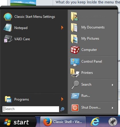

 Post subject: Re: Start Menu's Height
PostPosted: Sun Sep 17, 2017 6:01 am
Joined: Sat Sep 16, 2017 5:44 am
Here's a picture of my menu.

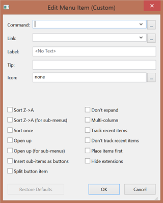

PostPosted: Sun Sep 17, 2017 6:24 am
There is another way to increase the height of the menu. Add a custom item to the right column in between any two items where you want the menu to grow taller. Keep all its fields blank and set the icon to: none. This will add true empty space, the item you added won't even be selectable with the keyboard.
PostPosted: Sun Sep 17, 2017 6:57 am
Hi. It did grow taller but I had to put a lot of them. I wish they still could add the option to make it taller like the Windows 7 Style. Better than nothing I guess. I'll have to tweak every skin. Thanks
