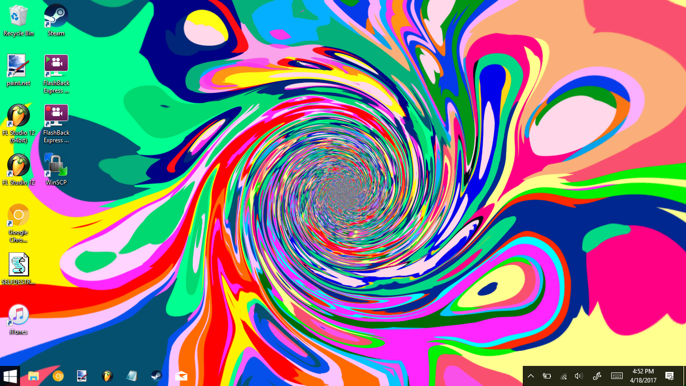

PostPosted: Tue Apr 18, 2017 2:00 pm
Posts: 25
Location: usa
Hello everyone!
I'm having some trouble with Classic Shell today.
My Desktop looks like this:
Can anyone help me?
hi
PostPosted: Sat Apr 22, 2017 3:13 pm
Joined: Wed Apr 05, 2017 6:55 pm
@AcroGen
Are you using textures in taskbar?
I'm having the same problem with textures.
See: viewtopic.php?f=7&t=7464

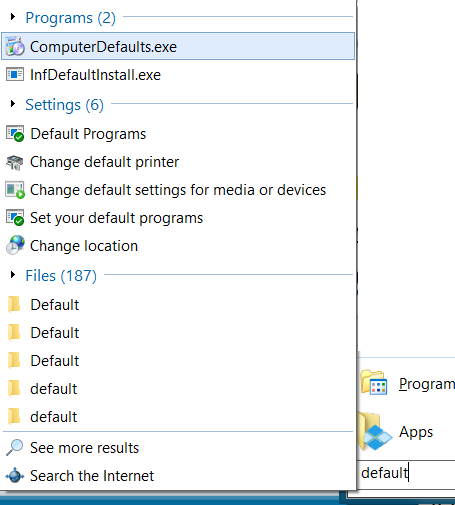

PostPosted: Thu May 11, 2017 3:45 pm
Joined: Thu May 11, 2017 3:37 pm
I just updated to the Creators Update and I've discovered an issue. Classic Start Menu's search no longer displays results from the PC Settings. Programs, Files, and Control Panel all show up in search, but not any of the Windows 10 PC Settings. I've tried toggling the option in the CSM Search Settings but to no avail. Is this a bug in the Creators Update?
File comment: Search for "default" in CSM, note the lack of PC Setting results

PostPosted: Fri May 12, 2017 7:24 am
Is Windows Search indexing enabled on your machine? Indexing must be enabled (Windows Search service must be running).
Also, make sure the following folder is being indexed by Windows Search:
%LocalAppdata%\Packages\windows.immersivecontrolpanel_cw5n1h2txyewy\LocalState\Indexed\Settings\xx-XX
where xx-XX is differently named depending on the language. It's part of the appdata folder is included in the user profile.
Open Control Panel -> Indexing Options. Make sure the above mentioned folder is being indexed. If not add this folder to the index by clicking the Modify button. You may have to expand folders quite a bit under the treeview to get to this folder.
C:\Users\<Your user name>\AppData\Local\Packages\windows.immersivecontrolpanel_cw5n1h2txyewy\LocalState\Indexed\Settings\en-US
Also, AppData folder might be hidden so once you get to C:\Users\<Your user name>, Appdata may not be listed in the Indexed Locations box. To fix this, close the dialog and close Indexing Options. Then you can unhide the Appdata folder from an elevated command prompt by giving the command:
attrib %userprofile%\appdata -h -r -s
Then open Indexing Options in Control Panel again.
Add the above mentioned folder to your search index.
Once Windows finishes indexing this folder, PC Settings from your C: drive should show up in Classic Start Menu search results.
PostPosted: Fri May 12, 2017 2:10 pm
Gaurav wrote:
Nope, Search Index service is running and the specified folder is already selected in the Search Index settings.

Hi, ich have got today the 1703 update (have classic shell 4.3.0) - now if I play Elite Dangerous I see the Classic Shell in the game, thats new. Sometimes if I change to desktop and back to the game the shell is unvisible, then again visible in the game. What can I do?
File comment: here the shell in the game
This problem has been reported before and is not specific to Creators Update. Unfortunately so far I have been unable to reproduce it. Might be related to a specific game, videocard, drivers, etc.
