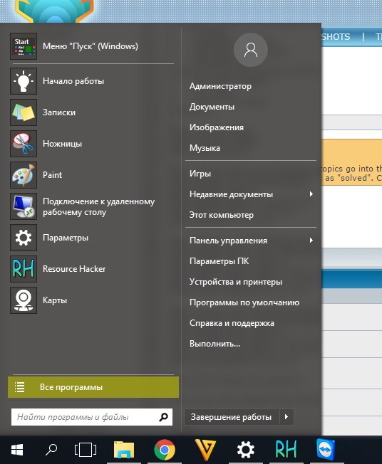

I have a problem that I can't solve. This swampy green color is disgusting. I found no option to change it. Help me please.

What you are looking for is "Highlight newly installed programs"
The green itself cant be changed without modifying the .skin or .skin7 file

I've replaced $StartInlineErrorText variable on $StartRoundButtonHover at 4 places in Metro.skin7, so new color is suitable for me.
I haven't understood how to work with mask, so made changes to variables only.
