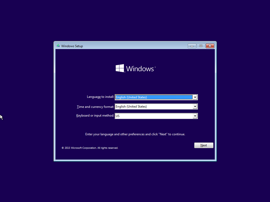

Boot from the disk. The way you do that is different for each computer. You may have to press F9, Esc, or some other key that lets you select a boot device.

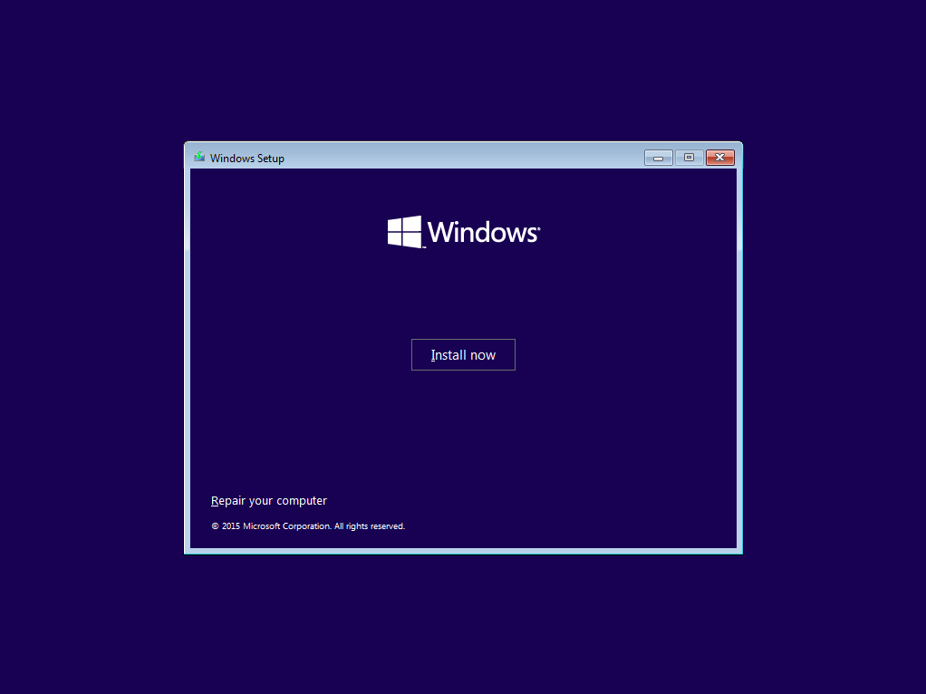

You will get a screen like this. Click Next.
Click "Repair your computer"

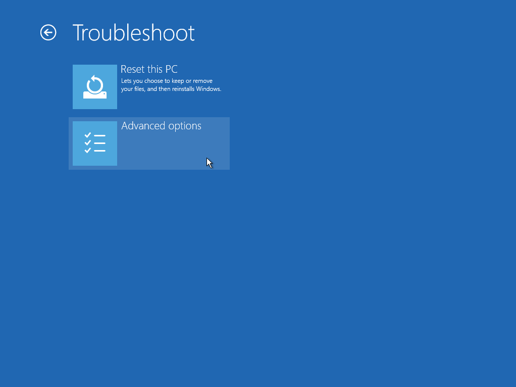

Click "Troubleshoot"

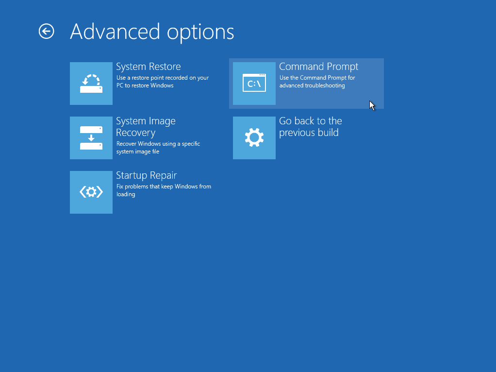

Click "Advanced options"

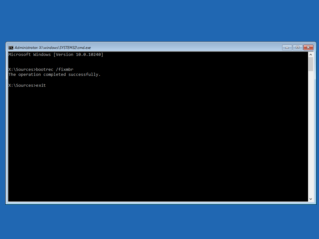

Click "Command Prompt"
Enter the commands
bootrec /fixmbr
exit
At this point remove the Windows 10 installation disk.

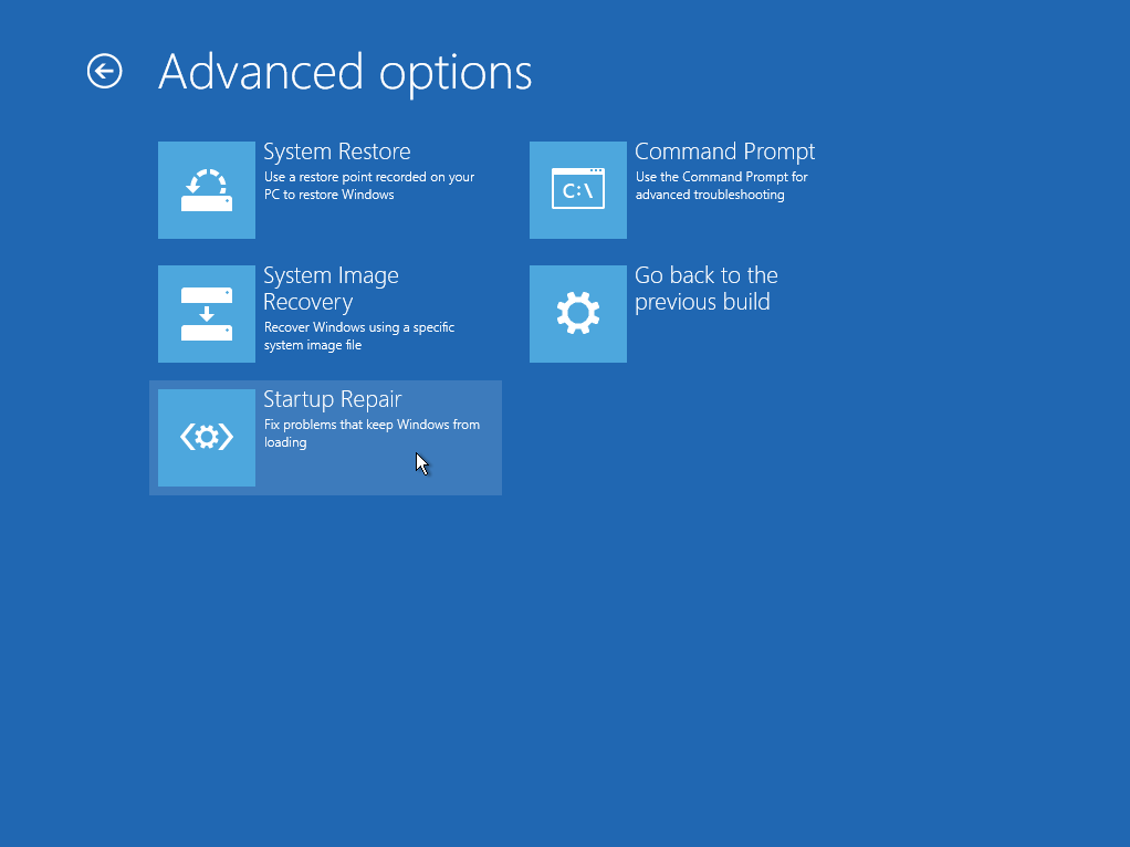

Click on “Troubleshoot”, then “Advanced Options”, then “Startup Repair”

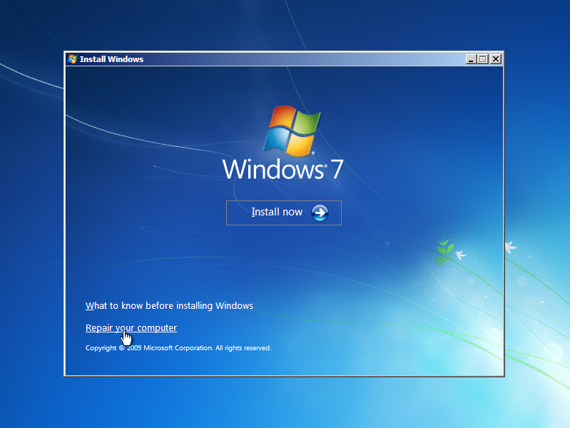

If you only have a Windows 7 installer disk, the procedure is the same, but the screens look a little differently.

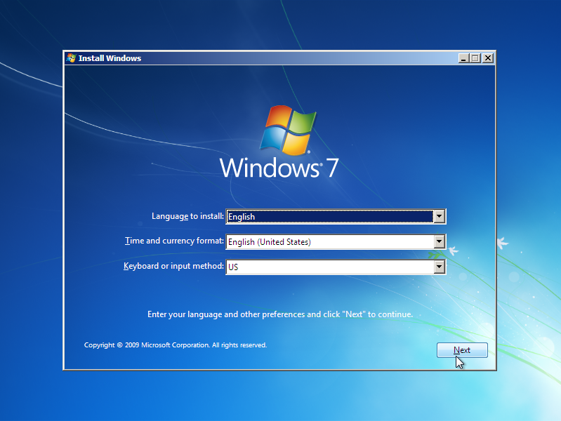

Boot from the Windows 7 disk

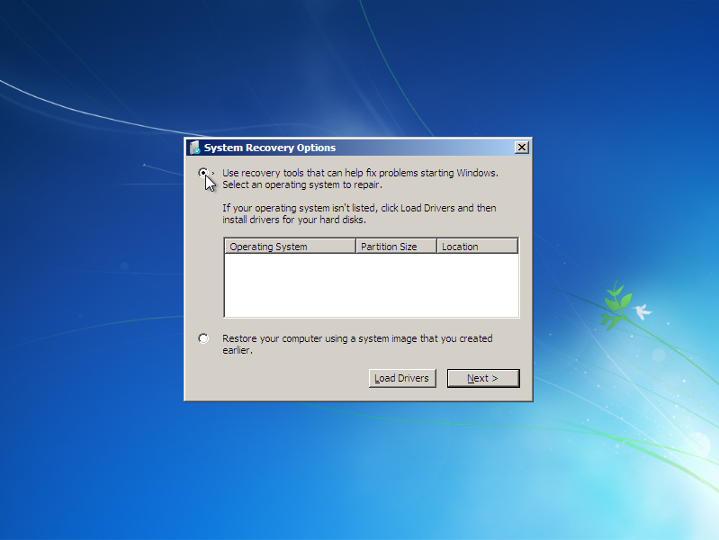

Select the first option "Use recovery tools...", click Next

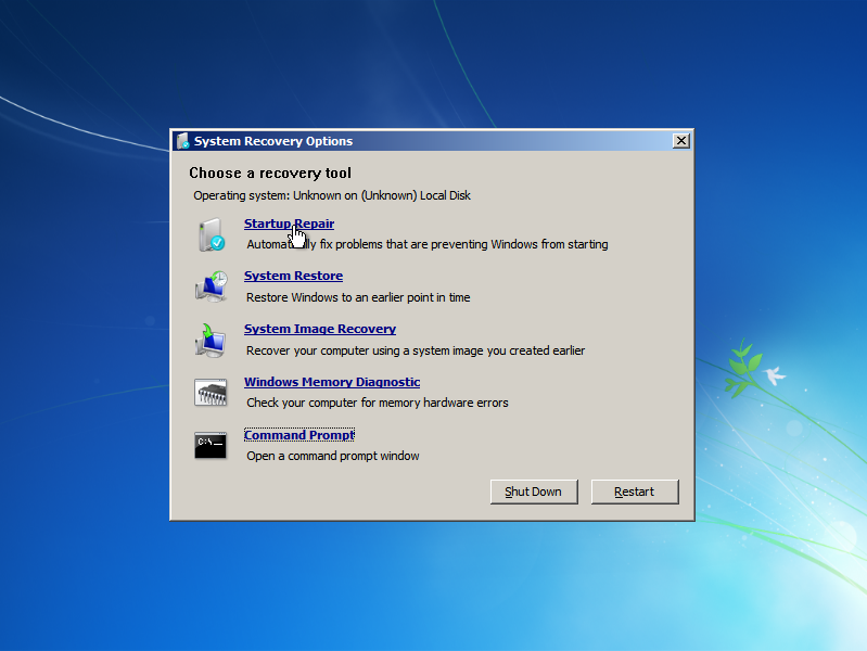

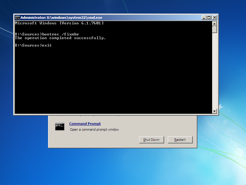

Enter the commands
bootrec /fixmbr
exit
Click on “Startup Repair”
When it is done, remove the Windows 7 disk and click "Finish"
