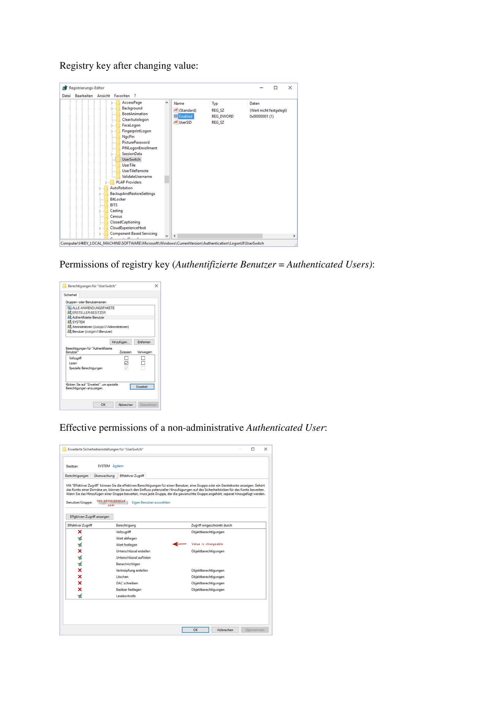

As my Windows is a German one, I’m only able to attach screenshots in German language.
Attachment Image1.jpg:
- Output window of command "winver"
- Window displayed after pressing Alt+F4 keys - after pressing "User switch", I am getting to login screen
Attachment Image2.jpg:
- modified value by non-administrative user of registry key item Enabled
- permissions of registry key UserSwitch
- special/advanced permissions of a non-administrative authenticated user
Registry permissions have not been altered after upgrade.
As you can see, registry key item Enabled may be modified by any authenticated user, whether administrative or not.
