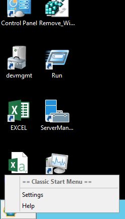

I am trying to disable right context menu bar on Windows Server 2012 R2 Standard 64 bit.
Is there way to do from classics Shell?

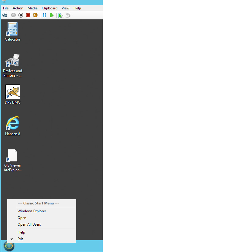

I am really appreciate for your response. I am able to disable right context but there are still some menu shows from classic menu. I need to complete disable that menu too. Can you please suggest/help? I have attached snap shot of classic context right click menu .

PostPosted: Thu Jun 09, 2016 10:48 am
Rename or delete the help file at C:\Program Files\Classic Shell\ClassicShell.chm.
There is a Registry DWORD value supported in HKLM\Software\IvoSoft\ClassicStartMenu called "EnableSettings". Set it to 0 to fully disable the Settings dialog.

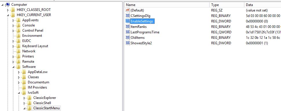

PostPosted: Thu Jun 09, 2016 11:36 am
Posts: 26
Hi Gaurav.
Thank you for your prompt response. Yes. I renamed file at C:\Program Files\Classic Shell\ClassicShell.chm.
Also set as value 0 for "EnableSetting" from the local gpedit.msc
But still showing same menu.
PostPosted: Thu Jun 09, 2016 12:02 pm
Your screenshot shows HKCU. The instructions mention HKEY_LOCAL_MACHINE. Also, after the change, you will have to log out and sign in again.

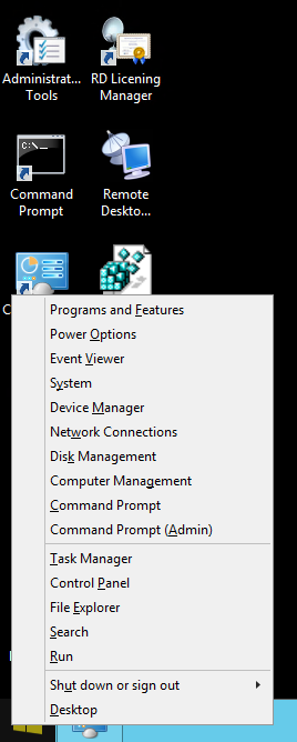

Post a screenshot again of what menu you are getting now.
PostPosted: Fri Jun 10, 2016 11:54 am
Posts: 26
I did setup 0 for "EnableSetting" from the HKEY_LOCAL_MACHINE. but still showing context right menu.

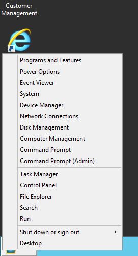

PostPosted: Fri Jun 10, 2016 9:39 pm
This menu is not part of Classic Shell.
This is the Win+X context menu added in Windows 8/Server 2012. It cannot be disabled as there is no Group Policy setting to disable it. You can go to C:\Users\<Your user name>\AppData\Local\Microsoft\Windows\WinX and rename or delete the folders there called Group 1,2,3 so the shortcuts can no longer be launched by right clicking the Start button.
Note: The menu will still appear, Windows did not provide a way to disable it but its shortcuts won't work.
PostPosted: Mon Jun 13, 2016 7:48 am
Posts: 26
Hi Gaurav.
Thank you very much for your response. Yes, the menu is not part of classic shell. Is there any way to disable right click win+x context menu from Classic Shell?
Thanks
PostPosted: Mon Jun 13, 2016 9:12 am
No at the most you can make sure "Right click opens Win+X menu" option on the Controls tab of Classic Start Menu Settings is UNchecked so the Classic Shell context menu replaces it for regular right click. Since you have already disabled items from the Start button's context menu, the Win+X menu will be hidden behind Shift+right click. Users can still access it by Shift+right click. Microsoft did not provide a Group Policy to completely suppress the Win+X menu.
