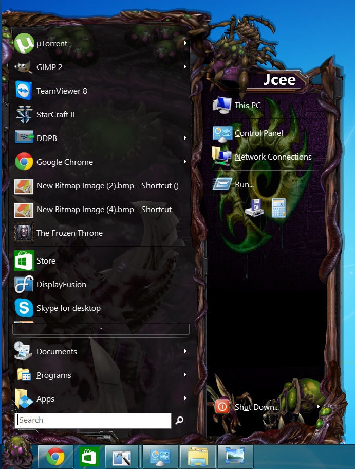

PostPosted: Wed Oct 01, 2014 2:24 pm
I've wanted to make a zerg theme, and start button for a while, since starcraft is my favorite game.
So anyways here it is. Zerg V1.1
its hasn't been completely cleaned yet, and I have a few kinks to work out, and features to add.. but it doesnt look bad Id say.
So ill probably be updating it soon.
EDIT: attached the .XCF (in the zip file) if you want to manually edit the skin (IE to your specific menu lengths to prevent stretching)

PostPosted: Tue Oct 07, 2014 6:57 pm
Oh My. Oh My.
The master has risen.
Terrific. I had to download a demo to figure out what the menu is about.
Very high definition. Even a built in shadow.
Like those winding snakey worm creatures.
Looks like many days of hard work, doing layers as well.
Good to see alternate menu skins, being made:)
I gather .xcf is a Gimp file?
I wonder if it's a good idea to upload a CSM backup XML configuration file?
That way we can have it set up the way you have it. Can the XML file be used on another computer?
The only big kinks that I see to be ironed out, are the submenu bottom padding or slices is wrong amount.
Looking at submenu bitmap 400 by 412. Slices add up to 430, instead of 412. That's an easy fix.
The name text location is a bit off as well. Something odd with the cutting off of the center rod.
I'm sure you know these anyway.
Got to say, hope this gets more skinners to come forward with their own.
Does take patience and time though, as I'm guilty of lack of those, these days.
Bye

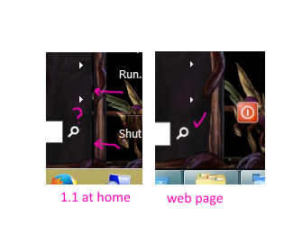

PostPosted: Tue Oct 07, 2014 9:41 pm
Hi Jcee.
First I thought it was the slices that's off for Mr. wormy in the middle column.
Comparing the screenshot and picture in web page, there is a difference. I think what has happened, is a layer in Gimp was moved slightly,
making a dark transparent line. That may be your intent, I don't know.
Good job with the buttons.
I should have zoomed in closer for the picture. Sorry.
Use the Ctrl and the mouse wheel to zoom in the web page.

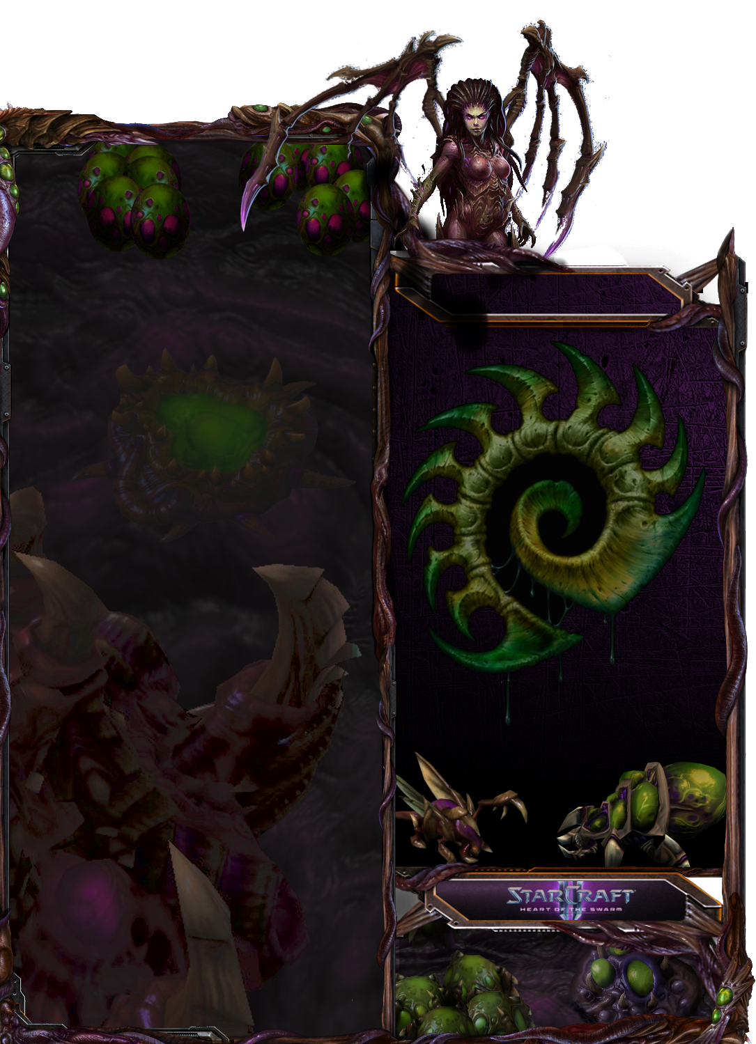

PostPosted: Sun Jul 24, 2016 11:48 pm
I've decided to update my Zerg skin; and am working on re-mastering the main bitmap (attached) However I have lost the program I was using to format the bitmaps properly for classic shell :P. Ill keep looking for that, and until then; heres the current design
Notes:
Increased space for usernames that are more than 5 characters long
Adding a portrait option/location
Replaced the Zerg queen, with the more Iconic Queen of Blades in the top right
Trying something with the UI to allow for a visual separation between shutdown, and everything else in the right column (something I tried to implement last time, but due to a busy schedule just dropped from the skin)
Adjusted coloring of the left columns insides (to make things prettier)
I am looking for any ideas and layout suggestions. Aswell as any features you would like to see added. Ill try to make use of some of the new features to allow a less stretched look, but I may have to re-make some of the resources from scratch for that. (which Ill probably make a terran variation If I do)
PostPosted: Mon Jul 25, 2016 9:29 pm
Va va Voom. What a queen.
Some of those additions elsewhere sure give menu image, a moist wet look.
The big part on left bottom looks dryer. I tried a plastic filter (exaggerated) on part of it, to see if it gets shiny.
Now it looks like wet internal organics. :lol:
The middle column border looks better now.
The "STARCRAFT" text can be a floating emblem, so it won't stretch.
Another new feature is png can be used instead of bitmap.
No need to convert image.
It might reduce the size of skin.

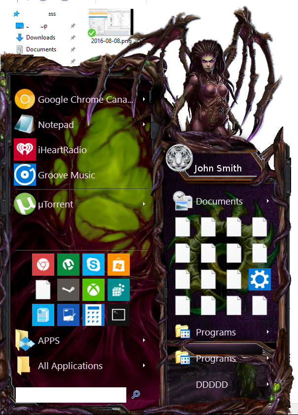

PostPosted: Sat Aug 20, 2016 3:04 am
Heres an update; still very messy, but I think ive just about gotten all the emblems and background added/aligned
none of the skin options have even been touched from the base (metalic skin)
Though I am brainstorming ideas
I briefly thought about imposing the user-picture upon the queen of blades face (like those corny *insert face here* billboards at tourist traps)
Currently however, i think it might be best to have the user-image skewered by either one of Kerrigans blades, or the post on the far right neversoft style http://www.deviantart.com/art/Neversoft-153259981
Also playing with the idea of using the second logo area for a windows version (or just removing it like I ended up doing with v 1.1)
Zergmetal3.skin [1.99 MiB]
Downloaded 7304 times

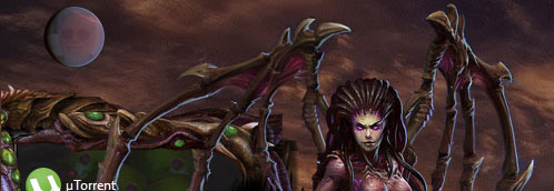

Here's another idea...what if you stuck a Zerg Cocoon in here:
or somewhere when the user image was enabled, and have the user image be mostly-visible through the translucent green membrane?
PostPosted: Sun Aug 21, 2016 4:22 pm
>Put cocoon up here
To what end? a user-picture?
Im not sure if it would be aesthetically sound to do so. Also cocoons are gray and dull and IMO break from the skins design elements.

If you did a .skin7, there's a bug with the jump list, and search pane. When you do a search, or hover over an item for recent programs/files in the 1st column, emblems disappear on you, and the column 1 stretches to accomodate your jump list or search query items. Column 2 seems to be missing, along with your emblems you made. Should I make a bug report?
At first I thought that the 'help and support' button 2 images up had a custom mouse hover select image for when its selected by the mouse. So I thought, you can make custom selector images for the start menu? But I'm not sure if that's possible.
PostPosted: Sun Aug 28, 2016 7:09 pm
Yea it sounds like an issue with classic shell, rather than my skin; though its odd that the issue would be with .skin7 because the only official skin to even use emblems is a .skin7 file :P so one would think it would have received more testing than .skin.
The stretching sounds intentional. and is part of why I designed the skin with emblems, and patterns so it can better support stretching.
but emblems disapearing when certain menu items are activated doesn't sound normal at all; you can create a bug report if you would like, otherwise ill probably make one myself once i get to that stage

[Update: heres a few potential portrait borders; Im probably going with the plain square (images2), However If you agree that this would make a good kerrigan replacement I might go that route, because it looks cool]
[Update2: This looks quite awsome, but I'd have to remove kerrigan (atleast when the user picture is present)]

PostPosted: Fri Oct 13, 2017 3:49 pm
Update: with user-image implemented
2 issues:
1. Don't know how to align user image to the left side of the second column (so for now its just 'aligned' to the current width of my menu)
2. Having issue with the user-image mask (to make the user image round)

PostPosted: Fri Oct 13, 2017 5:55 pm
Both will be available; to see kerrigan you just gotta disable the user image. If someone really wants both, I might have to just add a 3rd option that is similar to the mockup i did (with 'john smith' as username)

The John Smith one was a mockup? I thought it was the real thing. Yeah, I liked that one.
Lol Juniper, it's like your saying she's holding a cut off head. xD
PostPosted: Fri Nov 03, 2017 5:28 pm
No it was a quick throw together in photoshop :P (I wasnt ready at that time to do the changes I needed, and still cant)
The last image only 'works' because the width of the right column is fixed.
so you like the 'john smith' one best? I think i might too actually (I don't wanna get rid of kerrigan), but it needs a more zerg-like border (a shiny chrome ring hardly fits this theme) but maybe that doesn't matter because its just a transitional element?
It might be possible for me to include a 'fake' user-image by adding a setting that allows the user to include an image. The user however would have to format it properly to fit (IE round the edges, and make it the exact resolution needed) but this wont be clickable.
