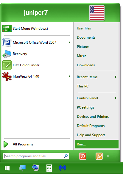

XP Metro-Glass Win10 [7style] for CSM version 4.3.1
For Windows 8 & 10. Will not work at all on Windows 7 due to Metro assigned color text in the skin file.
100%/96dpi,125%/120dpi,150%/144dpi exact size required
I'm copying off Splitwirez, where he made an XP classic skin with glass color support:
http://www.classicshell.net/forum/viewt ... =17&t=4420
These types of skins can never have all the color tints of the original XP Luna skin.
They can only have shades of one color.
I made it for Windows 10. It can be used on Windows 8 but does not look as good with default system settings.
Using this skin on Win 8 is actually quite disappointing.
Most of the time the menu in desktop mode (glass), is generally milky bright. The same goes for the default Win 8 taskbar color. :(
Not appealing to me anymore. Maybe I'm biased towards Win 10 more saturated Metro desktop color look?
One really has to work hard to get the menu and taskbar looking good on Win 8.
In the "Glass" skin setting, either use Win 8 system color adjustments
Control Panel\All Control Panel Items\Personalization\Color and Appearance, color mixer sliders,
or use CSM override glass settings in the "Menu Look" tab & taskbar color settings in the "Taskbar" tab.
For more intense color, switch to Metro skin setting, and adjust the Win 8 "Background color" in Start screen mode.
For more info settings for Windows 8 & 10 see this link for the similar 7 style flat version of this skin at the last entry of this post:
http://www.classicshell.net/forum/viewt ... 132#p36340
Note.
In most cases when using "Just shutdown icons with arrow" on Windows 8,
CSM setting "Menu color blending" should be at 0, or the tiny "Shutdown" text will be visible.
I thought about using the invisible font like in Vistalike skin, but that only makes the text invisible
and leaves the underline dash still visible. So forget that idea.
Edit: Now revision B version so 2nd column tint can be turned off,
to have just light grey 236/255 neutral look.
Ok Splitwirez, I will take you up on finishing your work on the classic 1/2 skin. :)

PostPosted: Tue Apr 28, 2020 6:27 pm
Here is the classic 1 & 2 style skin.
The Metro/glass colored programs arrow is a little bit lighter on hover.
I find it very hard to make as good as the original green arrow. Original has different tints of green.
Adjusting in red/green mask environment is really tricky.
If I make it just like that green brightness, the highlight gets too blown out with other colors. It's a compromise as always.
I'm definitely proud of the XP taskbar that turns the flat Win10 taskbar into the top/bottom texture of XP that tracks the Metro/glass color. :)

PostPosted: Fri May 22, 2020 10:41 pm
Edit: I got totally sidetracked talking about Open-Shell. :)
Both of our menus are similar.
On yours, what it looks like is you used the blue luna bitmap along with a tint shifted blue to red bitmap mask for the glass color.
This makes the menu smoother looking and brighter as the green in the mask added more brightness together with the luna bitmap.
On mine, there is only the mask bitmap. That has red for glass/metro color,
along with slightly reduced green for a slightly darker brightness.
Both skins look good on Windows 10.
